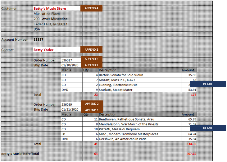

In this example, we can define four templates types:

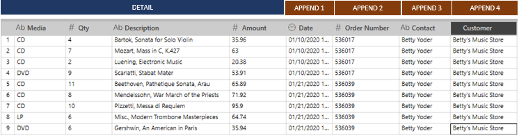

The templates above extract data and assemble the following:
Assembly of a records from a detail template and append templates.
Columns extracted using an append template are associated with the detail record if the append level begins anywhere on or before the first detail line. The extracted column values are appended to all subsequent detail records until the next occurrence of the append column in the report. For example, in the illustration above, a separate detail record is created for each transaction. The customer name, contact and ship date columns, which are extracted using append templates, are associated with the transaction below them.
