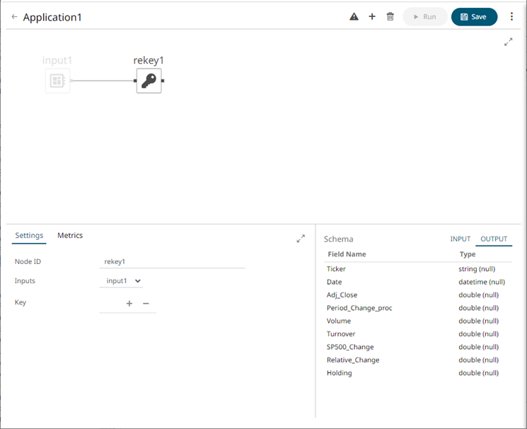

The Rekey node
icon displays in the Graph pane, as well as the properties to be defined in the Operator Settings pane, and the preview of the data in the Schema pane.
The right (outbound) edge allows you to connect to the other operators.
- In the Operator Settings pane, define or select the following required properties:

- In the Key section, click
to select the new key column in the drop-down list box from the data source schema. Repeat to add more.
You can also delete a key column in the list by selecting its checkbox and clicking .

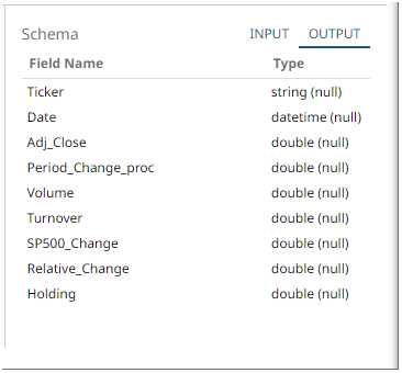

The preview of the data (OUTPUT) is displayed in the Schema pane.

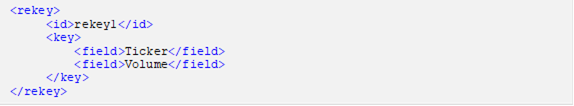

Example
