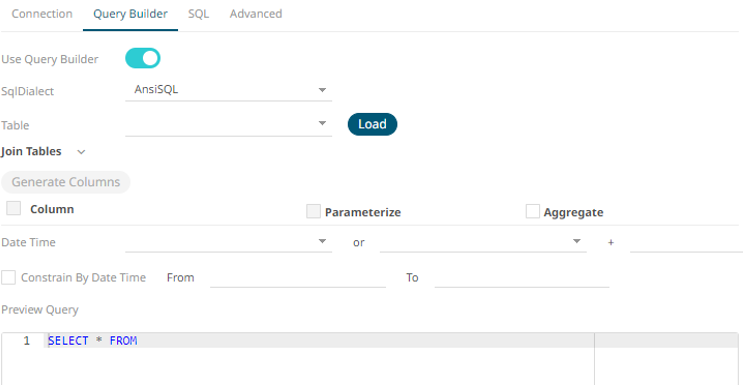

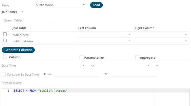

- Query definition and execution can be done, using either the query builder or freeform SQL. To use the query builder, select the Query Builder tab. Otherwise, proceed to step 5.
The Use Query Builder option is turned on by default.
- Select the appropriate SQL Dialect in the drop-down list to be able to generate the correct SQL for the required data repository.
- In the Table field, click
to populate the drop-down list with tables. Select a table.
The SQL query is generated and displayed in the Preview Query text box.

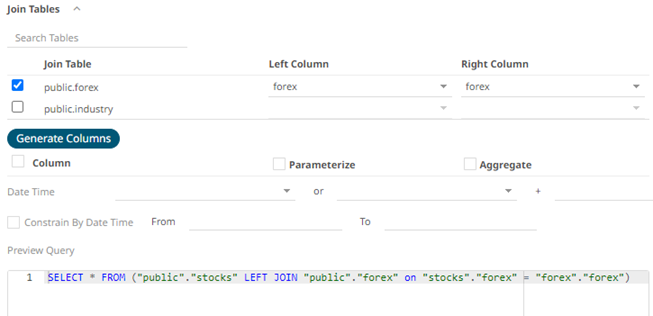

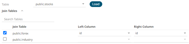

Also, expanding the Join Tables displays the list of tables that you can join.
Use Search Tables to filter the list.
- Perform a join by checking one or more tables in the list.
You can also opt to select other common fields.

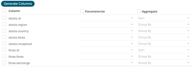

- Click
. The columns populate the Output Column section.
- Individual columns can be added by selecting the corresponding Column checkbox in the Output Column listing. To select all of the columns, select the topmost checkbox.
- If the data returned is to be aggregated, then the Aggregate checkbox should be selected. For each selected column, the possible aggregation methods are listed including:
- Text Columns: Last, First, Count, Group By
- Date Columns: Count, Min, Max, Group By
- Numeric Columns: Last, First, Sum, Count, Min, Max, Mean, Group By
- Select the Parameterize checkbox and match the parameter to the appropriate column. By default, they will be matched by name.
The appropriate SQL Query is updated in the Preview Query text box.

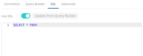

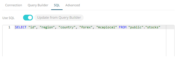

- To use freeform SQL, select the SQL tab and turn on Use SQL toggle button.
- Modify the SQL-like query language in the User Query text box.
NOTE:
- If you initially used the Query Builder then switched to the freeform SQL option, the content of Preview Query is copied to the User Query text box.
- Switching back to the Query Builder, the Preview Query is updated, keeping the User Query unmodified.
is enabled when User Query is non-empty and different from Preview Query.Click this button to update the User Query from the query builder.

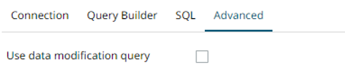

- Select the Advanced tab.
Set the following property, if needed:
Porperty Description Use data modification query
Signals that the table is created for writing data. This property is also used for filtering out target data tables for further data update action configuration.
