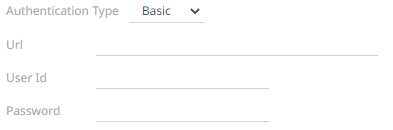

Property Description Authentication Type
Basic
Enter the URL of the REST API. Then enter the User Id and the Password that will be used to the connect to the REST API.

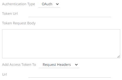

OAuth
Then enter the following settings:
Token URL – The URL to retrieve the access token from.
Token Request Body – The request body used for access token requests.
Add Access Token To - The Access token retrieved from the Token URL can be added to headers, URL or request body, depending on how the REST endpoint needs the token.
Request Header - A header is automatically added to the REST API request.
Request URL - The URL needs to be manually parameterised with a {access_token} parameter, before calling the REST API, the parameter is replaced with the actual token.
Request Body - The Request Body needs to be manually parameterised with a {access_token} parameter, before calling the REST API, the parameter is replaced with the actual token.
