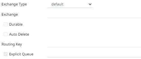

- Select any of the following Exchange Types:
Exchange Type Description Default
A direct exchange with no name that is pre-declared by the broker.
Selecting this exchange type disables the Exchange section (Exchange and Routing Key properties).

- Depending on the selected Exchange Type, select or define the following:
Exchange Type Property Description Exchange
Name of the exchange.
Durable
Enable so the exchange can survive a broker restart.
Auto Delete
Enable so the exchange is deleted when the last queue is unbound from it.
Routing Key
The routing key used to deliver messages to queues.
Headers
This field is only available when the message type is Header.
Binding a queue to a Headers exchange is possible using more than one header for matching. Setting x-match to any, means just one matching value is sufficient. Setting it to all means that all values must match. Default is x-match=all.
- Select the Explicit Queue checkbox and enter the custom queue name. Then enter or enable the following properties:
Queue Property Description Porperties
The custom queue property.
Durable
Enable so the queue can survive a broker restart.
Auto Delete
Enable so the queue that had the least consumer will be deleted when that connection closes.
