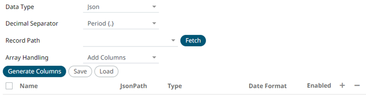

    • JSON
      If JSON is selected, click  to fetch the Record Paths then select one. This allows the identification of multiple records within the JSON document. Then select the Array Handling setting.

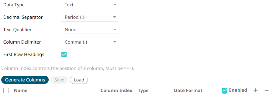

    • Text
      If Text has been selected, confirm the Decimal Separator, Text Qualifier, Column Delimiter, and if the first row of the message includes column headings.

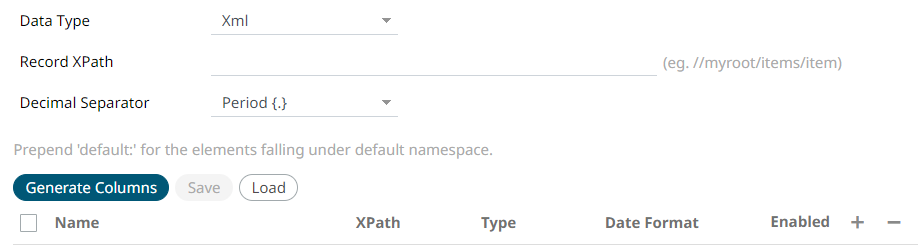

    • XML
      If XML is selected, enter the Record XPath which allows the identification of multiple records within the XML document (e.g., //myroot/items/item).

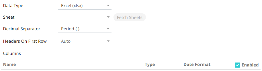

    • Excel (xlsx) or Excel (xls)
      For Excel file type, select the required sheet, decimal separator, and adjust the headers on first row, if needed.

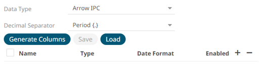

    • Arrow IPC
