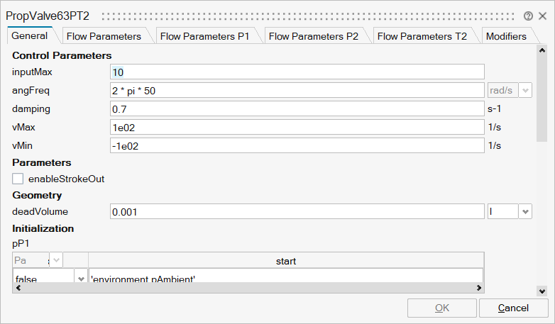

mo_inputMax | inputMax | Input value for 100 % open | Scalar | |
mo_angFreq | angFreq | Angular frequency | Scalar | |
mo_damping | damping | Damping | Scalar | |
mo_vMax | vMax | max. Velocity | Scalar | |
mo_vMin | vMin | min. Velocity | Scalar | |
mo_enableStrokeOut | enableStrokeOut | Enable Stroke Output | Number | 0 |
mo_inputMaxPartial | inputMaxPartial | Scalar | ||
mo_forwardFluidPropertiesBT | forwardFluidPropertiesBT | Scalar | true | |
mo_deadVolume | deadVolume | Dead volume at ports | Scalar | |
mo_pP1 | pP1 | pP1 | Structure | |
mo_pP1/fixed | fixed | Cell of scalars | true | |
mo_pP1/start | start | Cell of scalars | ||
mo_pT1 | pT1 | pT1 | Structure | |
mo_pT1/fixed | fixed | Cell of scalars | true | |
mo_pT1/start | start | Cell of scalars | ||
mo_pP2 | pP2 | pP2 | Structure | |
mo_pP2/fixed | fixed | Cell of scalars | true | |
mo_pP2/start | start | Cell of scalars | ||
mo_pT2 | pT2 | pT2 | Structure | |
mo_pT2/fixed | fixed | Cell of scalars | true | |
mo_pT2/start | start | Cell of scalars | ||
mo_pA/start | start | Cell of scalars | ||
mo_pB | pB | pB | Structure | |
mo_pB/fixed | fixed | Cell of scalars | true | |
mo_pB/start | start | Cell of scalars | ||
mo_initType | initType | Type of initialization (1: no init, 2: steady state, 3/4: initial output) | Structure | |
mo_initType/choice1 | Modelica.Blocks.Types.Init.NoInit | Number | 0 | |
mo_initType/choice2 | Modelica.Blocks.Types.Init.SteadyState | Number | 0 | |
mo_initType/choice3 | Modelica.Blocks.Types.Init.InitialState | Number | 0 | |
mo_initType/choice4 | Modelica.Blocks.Types.Init.InitialOutput | Number | 0 | |
mo_Stroke | Stroke | Stroke | Structure | |
mo_Stroke/fixed | fixed | Cell of scalars | true | |
mo_Stroke/start | start | Cell of scalars | ||
mo_Velocity | Velocity | Velocity | Structure | |
mo_Velocity/fixed | fixed | Cell of scalars | true | |
mo_Velocity/start | start | Cell of scalars |

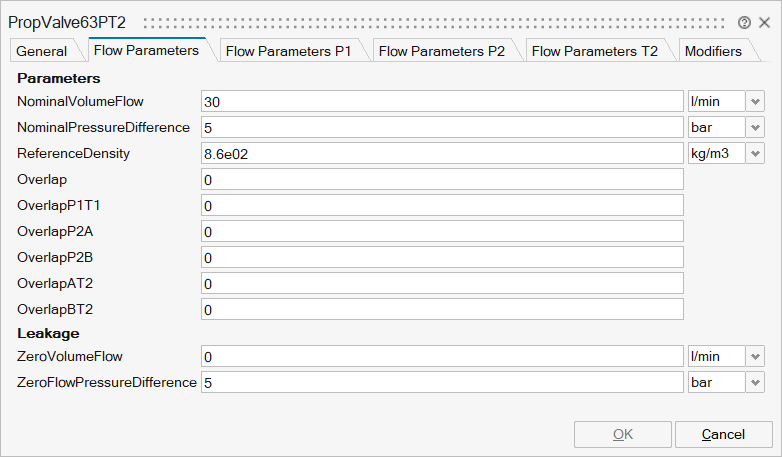

mo_NominalVolumeFlow | NominalVolumeFlow | Nominal volume flow | Scalar | |
mo_NominalPressureDifference | NominalPressureDifference | Nominal pressure difference | Scalar | |
mo_ReferenceDensity | ReferenceDensity | Reference density for volume flow and pressure difference | Scalar | |
mo_Overlap | Overlap | Valve edge general relative overlap | Scalar | |
mo_OverlapP1T1 | OverlapP1T1 | Valve edge P1T1 relative overlap | Scalar | |
mo_OverlapP2A | OverlapP2A | Valve edge P2A relative overlap | Scalar | |
mo_OverlapP2B | OverlapP2B | Valve edge P2B relative overlap | Scalar | |
mo_OverlapAT2 | OverlapAT2 | Valve edge AT2 relative overlap | Scalar | |
mo_OverlapBT2 | OverlapBT2 | Valve edge BT2 relative overlap | Scalar | |
mo_ZeroVolumeFlow | ZeroVolumeFlow | Volume flow due to leakage | Scalar | |
mo_ZeroFlowPressureDifference | ZeroFlowPressureDifference | Pressure difference for leakage flow | Scalar |

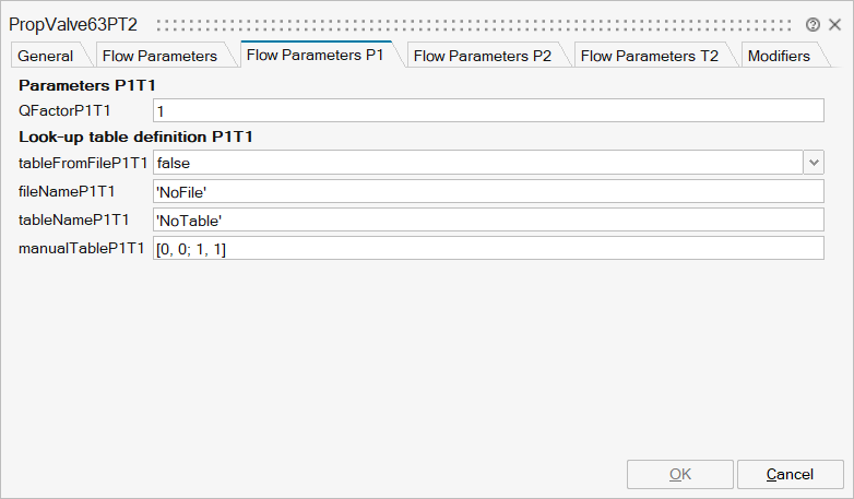

mo_QFactorP1T1 | QFactorP1T1 | Factor for edge P1T1 specific flow adjustment | Scalar | |
mo_tableFromFileP1T1 | tableFromFileP1T1 | Table is provided by file | Scalar | true |
mo_fileNameP1T1 | fileNameP1T1 | File where look-up table is stored | String | |
mo_tableNameP1T1 | tableNameP1T1 | Table name on file | String | |
mo_manualTableP1T1 | manualTableP1T1 | Manually provided look-up table | Matrix |

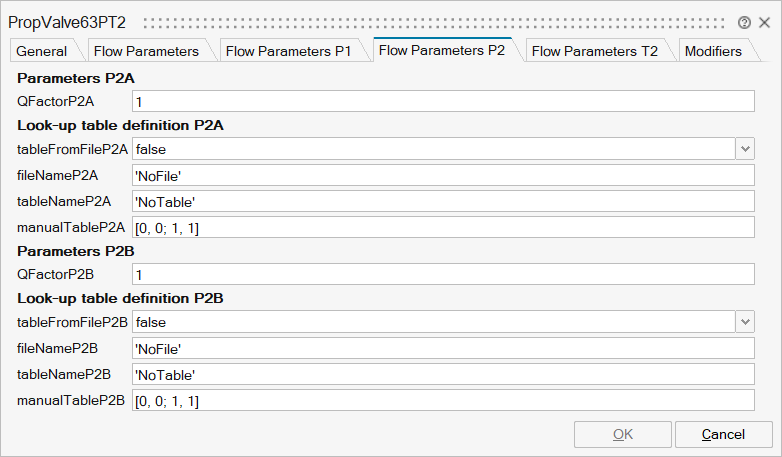

mo_QFactorP2A | QFactorP2A | Factor for edge P2A specific flow adjustment | Scalar | |
mo_tableFromFileP2A | tableFromFileP2A | Table is provided by file | Scalar | true |
mo_fileNameP2A | fileNameP2A | File where look-up table is stored | String | |
mo_tableNameP2A | tableNameP2A | Table name on file | String | |
mo_manualTableP2A | manualTableP2A | Manually provided look-up table | Matrix | |
mo_QFactorP2B | QFactorP2B | Factor for edge P2B specific flow adjustment | Scalar | |
mo_tableFromFileP2B | tableFromFileP2B | Table is provided by file | Scalar | true |
mo_fileNameP2B | fileNameP2B | File where look-up table is stored | String | |
mo_tableNameP2B | tableNameP2B | Table name on file | String | |
mo_manualTableP2B | manualTableP2B | Manually provided look-up table | Matrix |

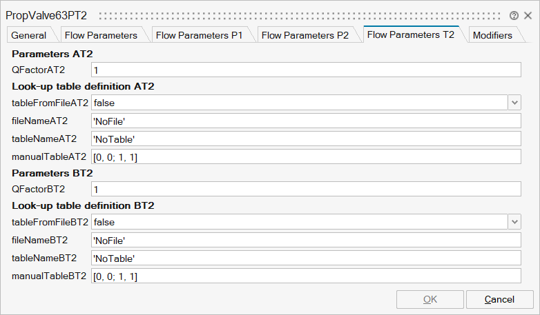

mo_QFactorAT2 | QFactorAT2 | Factor for edge AT2 specific flow adjustment | Scalar | |
mo_tableFromFileAT2 | tableFromFileAT2 | Table is provided by file | Scalar | true |
mo_fileNameAT2 | fileNameAT2 | File where look-up table is stored | String | |
mo_tableNameAT2 | tableNameAT2 | Table name on file | String | |
mo_manualTableAT2 | manualTableAT2 | Manually provided look-up table | Matrix | |
mo_QFactorBT2 | QFactorBT2 | Factor for edge BT2 specific flow adjustment | Scalar | |
mo_tableFromFileBT2 | tableFromFileBT2 | Table is provided by file | Scalar | true |
mo_fileNameBT2 | fileNameBT2 | File where look-up table is stored | String | |
mo_tableNameBT2 | tableNameBT2 | Table name on file | String | |
mo_manualTableBT2 | manualTableBT2 | Manually provided look-up table | Matrix |

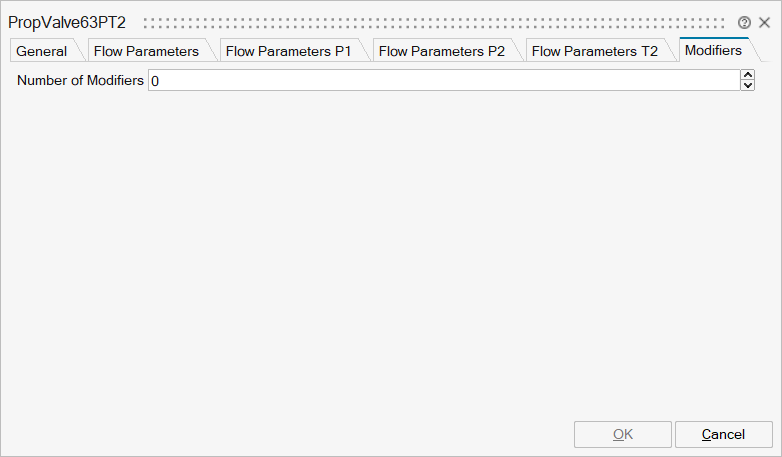

mo__modifiers/varname | Variable name | Cell of strings | 'volumeFlowP1' | |
mo__modifiers/value | Value |
