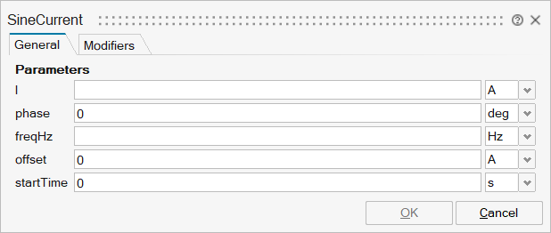

This current source uses the corresponding signal source of the Modelica.Blocks.Sources package. Care for the meaning of the parameters in the Blocks package. Furthermore, an offset parameter is introduced, which is added to the value calculated by the blocks source. The startTime parameter allows to shift the blocks source behavior on the time axis.
SineCurrent_0
mo_I
I
Amplitude of sine wave
Scalar
mo_phase
phase
Phase of sine wave
Scalar
mo_freqHz
freqHz
Frequency of sine wave
Scalar
mo_offset
offset
Current offset
Scalar
mo_startTime
startTime
Time offset
Scalar

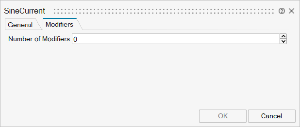

SineCurrent_1
mo__nmodifiers
Number of Modifiers
Specifies the number of modifiers
Number
mo__modifiers
Modifiers
Add new modifier
Structure
mo__modifiers/varname
Variable name
Cell of strings
'v'
'i'
mo__modifiers/attribute
Attribute
Cell of strings
'start'
'fixed'
mo__modifiers/value
Value
p
implicit
Positive electrical pin
input
1
n
implicit
Negative electrical pin
output
1
