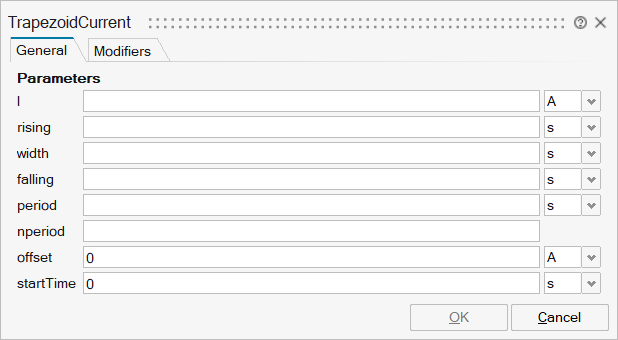

This current source uses the corresponding signal source of the Modelica.Blocks.Sources package. Care for the meaning of the parameters in the Blocks package. Furthermore, an offset parameter is introduced, which is added to the value calculated by the blocks source. The startTime parameter allows to shift the blocks source behavior on the time axis.
TrapezoidCurrent_0
mo_I
I
Amplitude of trapezoid
Scalar
mo_rising
rising
Rising duration of trapezoid
Scalar
mo_width
width
Width duration of trapezoid
Scalar
mo_falling
falling
Falling duration of trapezoid
Scalar
mo_period
period
Time for one period
Scalar
mo_nperiod
nperiod
Number of periods (< 0 means infinite number of periods)
Scalar
mo_offset
offset
Current offset
Scalar
mo_startTime
startTime
Time offset
Scalar

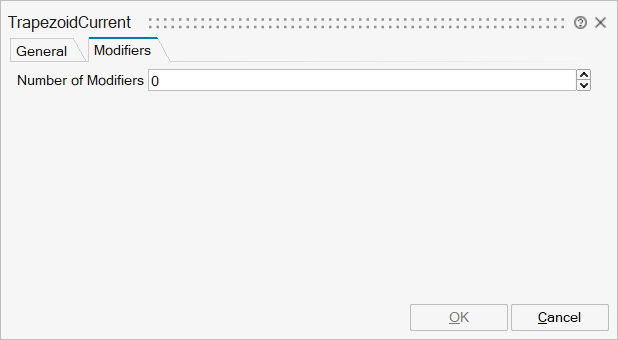

TrapezoidCurrent_1
mo__nmodifiers
Number of Modifiers
Specifies the number of modifiers
Number
mo__modifiers
Modifiers
Add new modifier
Structure
mo__modifiers/varname
Variable name
Cell of strings
'v'
'i'
mo__modifiers/attribute
Attribute
Cell of strings
'start'
'fixed'
mo__modifiers/value
Value
