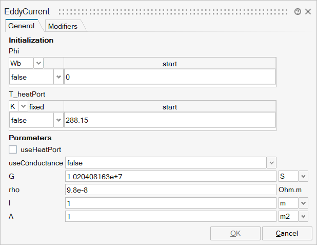

EddyCurrent_0
mo_Phi
Phi
Phi
Structure
mo_Phi/fixed
fixed
Cell of scalars
true
false
mo_Phi/start
start
Cell of scalars
mo_T_heatPort
T_heatPort
T_heatPort
Structure
mo_T_heatPort/fixed
fixed
Cell of scalars
true
false
mo_T_heatPort/start
start
Cell of scalars
mo_useHeatPort
useHeatPort
=true, if heatPort is enabled
Number
0
1
mo_T
T
Fixed device temperature if useHeatPort = false
Scalar
mo_useConductance
useConductance
Use conductance instead of geometry data and rho
Scalar
true
false
mo_G
G
Equivalent loss conductance G=A/rho/l
Scalar
mo_rho
rho
Resistivity of flux tube material (default: Iron at 20degC)
Scalar
mo_l
l
Average length of eddy current path
Scalar
mo_A
A
Cross sectional area of eddy current path
Scalar
mo_R
R
Electrical resistance of eddy current path
Scalar

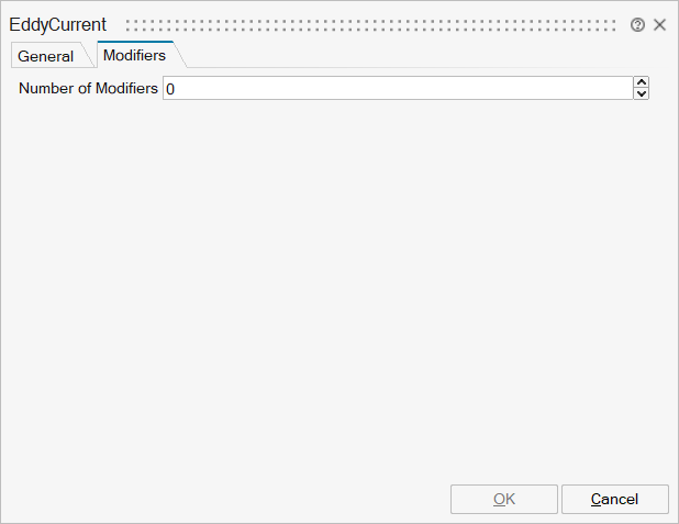

EddyCurrent_1
mo__nmodifiers
Number of Modifiers
Specifies the number of modifiers
Number
mo__modifiers
Modifiers
Add new modifier
Structure
mo__modifiers/varname
Variable name
Cell of strings
'V_m'
'LossPower'
mo__modifiers/attribute
Attribute
Cell of strings
'start'
'fixed'
mo__modifiers/value
Value
