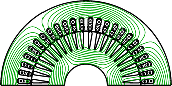

Fig. 1: Field lines of a four pole induction machine

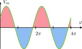

Fig. 2: Magnetic potential difference of a four pole machine, where is the angle of the spatial domain with respect to one pole pair

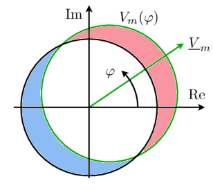

Fig. 3: Spatial distribution of the magnetic potential difference (red shade = positive sine wave, blue shade = negative sine wave) including complex phasor representing this spatial distribution
