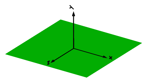

Visualizing the ground (box in z=0)
    Ground
Modelica/Mechanics/MultiBody/Visualizers
This shape visualizes the x-y plane by a box.

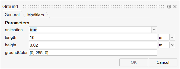

Ground_0
mo_animation
animation
= true, if animation of ground shall be enabled
Scalar
true
false
mo_length
length
Length and width of box (center is at x=y=0)
Scalar
mo_height
height
Height of box (upper surface is at z=0, lower surface is at z=-height)
Scalar
mo_groundColor
groundColor
Color of box
Vector of size 3

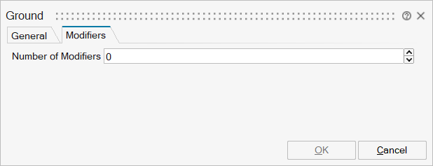

Ground_1
mo__nmodifiers
Number of Modifiers
Specifies the number of modifiers
Number
mo__modifiers
Modifiers
Add new modifier
Structure
mo__modifiers/varname
Variable name
Cell of strings
mo__modifiers/attribute
Attribute
Cell of strings
'start'
'fixed'
mo__modifiers/value
Value
