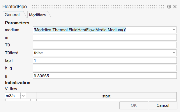

HeatedPipe_0
mo_medium
medium
Medium in the component
FromModelica('Modelica.Thermal.FluidHeatFlow.Media.Medium')
FromModelica('Modelica.Thermal.FluidHeatFlow.Media.Air_30degC')
FromModelica('Modelica.Thermal.FluidHeatFlow.Media.Air_70degC')
FromModelica('Modelica.Thermal.FluidHeatFlow.Media.MineralOil')
FromModelica('Modelica.Thermal.FluidHeatFlow.Media.Water')
FromModelica('Modelica.Thermal.FluidHeatFlow.Media.Gylcol20_20degC')
FromModelica('Modelica.Thermal.FluidHeatFlow.Media.Gylcol50_20degC')
FromModelica('Modelica.Thermal.FluidHeatFlow.Media.Water_10degC')
FromModelica('Modelica.Thermal.FluidHeatFlow.Media.Water_90degC')
mo_m
m
Mass of medium
Scalar
mo_T0
T0
Initial temperature of medium
Scalar
mo_T0fixed
T0fixed
Initial temperature guess value or fixed
Scalar
true
false
mo_tapT
tapT
Defines temperature of heatPort between inlet and outlet temperature
Scalar
mo_dpNomMin
dpNomMin
Scalar
mo_k
k
Scalar
mo_useHeatPort
useHeatPort
=true, if HeatPort is enabled
Number
0
1
mo_h_g
h_g
Geodetic height (height difference from flowPort_a to flowPort_b)
Scalar
mo_g
g
Gravitation
Scalar
mo_V_flow
V_flow
V_flow
Structure
mo_V_flow/fixed
fixed
Cell of scalars
true
false
mo_V_flow/start
start
Cell of scalars
mo_T
T
T
Structure
mo_T/fixed
fixed
Cell of scalars
true
false
mo_T/start
start
Cell of scalars
mo_T_a
T_a
T_a
Structure
mo_T_a/fixed
fixed
Cell of scalars
true
false
mo_T_a/start
start
Cell of scalars
mo_T_b
T_b
T_b
Structure
mo_T_b/fixed
fixed
Cell of scalars
true
false
mo_T_b/start
start
Cell of scalars
mo_T_q
T_q
T_q
Structure
mo_T_q/fixed
fixed
Cell of scalars
true
false
mo_T_q/start
start
Cell of scalars
mo_h
h
h
Structure
mo_h/fixed
fixed
Cell of scalars
true
false
mo_h/start
start
Cell of scalars
mo_V_flowLaminar
V_flowLaminar
Laminar volume flow
Scalar
mo_dpLaminar
dpLaminar
Laminar pressure drop
Scalar
mo_V_flowNominal
V_flowNominal
Nominal volume flow
Scalar
mo_dpNominal
dpNominal
Nominal pressure drop
Scalar
mo_frictionLoss
frictionLoss
Part of friction losses fed to medium
Scalar

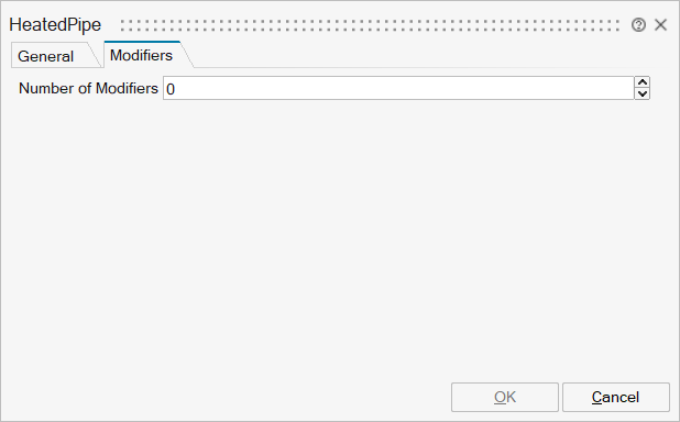

HeatedPipe_1
mo__nmodifiers
Number of Modifiers
Specifies the number of modifiers
Number
mo__modifiers
Modifiers
Add new modifier
Structure
mo__modifiers/varname
Variable name
Cell of strings
'dp'
'Q_flow'
'dT'
'pressureDrop'
'volumeFlow'
'Q_friction'
'Q_flowHeatPort'
mo__modifiers/attribute
Attribute
Cell of strings
'start'
'fixed'
mo__modifiers/value
Value
