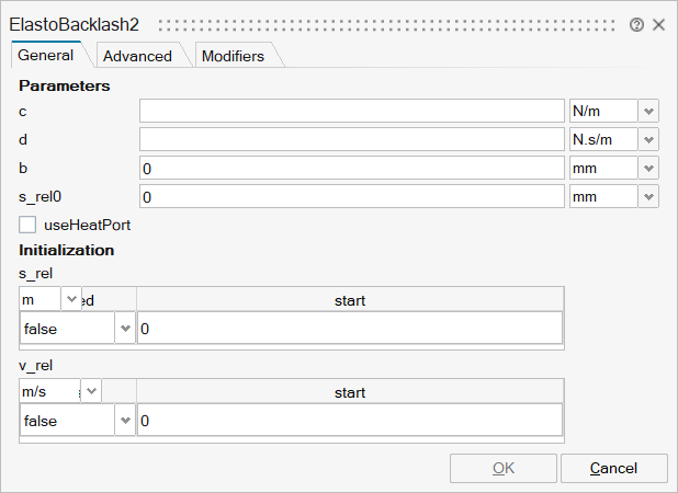

mo_c | c | Spring constant (c > 0 required) | Scalar | |
mo_d | d | Damping constant | Scalar | |
mo_b | b | Total backlash | Scalar | |
mo_s_rel0 | s_rel0 | Unstretched spring length | Scalar | |
mo_bMax | bMax | Backlash in range bMin <= s_rel - s_rel0 <= bMax | Scalar | |
mo_bMin | bMin | Backlash in range bMin <= s_rel - s_rel0 <= bMax | Scalar | |
mo_s_rel | s_rel | s_rel | Structure | |
mo_s_rel/fixed | fixed | Cell of scalars | true | |
mo_s_rel/start | start | Cell of scalars | ||
mo_v_rel | v_rel | v_rel | Structure | |
mo_v_rel/fixed | fixed | Cell of scalars | true | |
mo_v_rel/start | start | Cell of scalars |

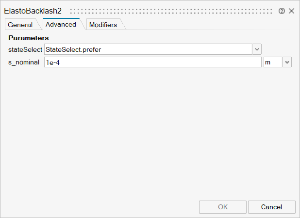

mo_stateSelect | stateSelect | Priority to use s_rel and v_rel as states | Structure | |
mo_stateSelect/choice1 | StateSelect.never | Number | 0 | |
mo_stateSelect/choice2 | StateSelect.avoid | Number | 0 | |
mo_stateSelect/choice3 | StateSelect.default | Number | 0 | |
mo_stateSelect/choice4 | StateSelect.prefer | Number | 0 | |
mo_stateSelect/choice5 | StateSelect.always | Number | 0 | |
mo_s_nominal | s_nominal | Nominal value of s_rel (used for scaling) | Scalar |
