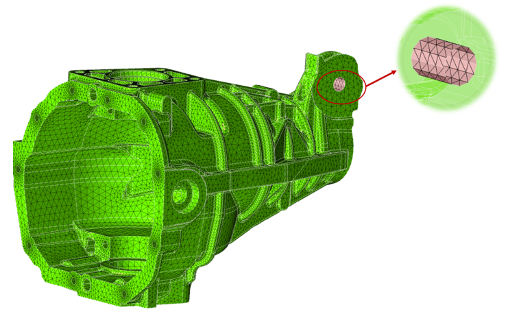

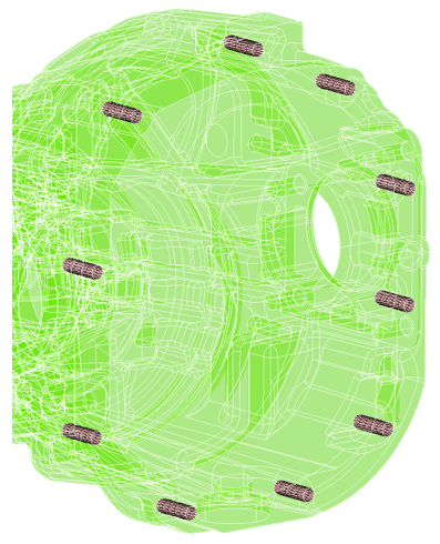

Create Solid Bolds for Assembly
From the menu bar, click .
The Bolt Modeling Ribbon opens.
From the Bolt Modelling Ribbon, 3D
Bolt group, click the Create Bolt
tool.

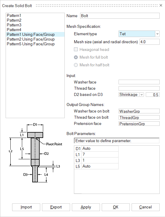

The Create Solid Bolt dialog opens.
In the Create Solid Bolt dialog, enter the values as shown
below.
Figure 1. Bolt Parameters

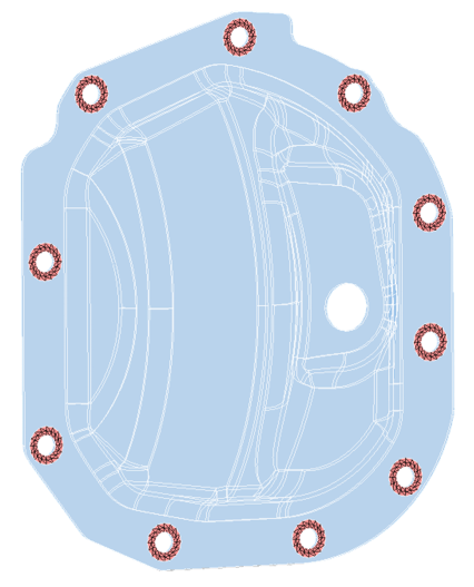

For Washer face Input, select the disc faces of the Cover body in the modeling window.
Figure 2. Select Disc Faces of Cover Body for Washer Face
For Thread face Input, select the cylindrical faces of the carrier body in the
modeling window.
Figure 3. Select Cylindrical Faces of Carrier Body for Thread Face
For D2 based on D3, set the Shrinkage value to
0 and click OK.
Ten solid bolts are created.
In the Assembly tab of the Model Browser, select the 10
solid bolts, right-click in the modeling window, and
select Merge from the context menu.
In the Assembly tab of the Model Browser, the bolts are merged into a single bolt.

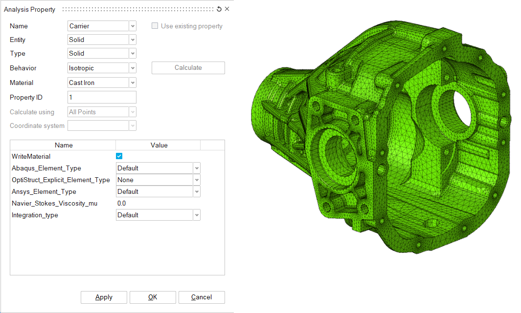

- In the modeling window, select the Carrier body.
In the Analysis Property dialog, enter the values as shown
below and click Apply.
Figure 5. Carrier Body Property

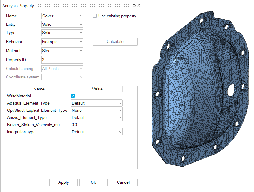

Create a property for the Cover body.
- In the modeling window, select the Cover body.
- In the Analysis Property dialog, enter the values as shown below and click Apply.
Figure 6. Cover Body Property

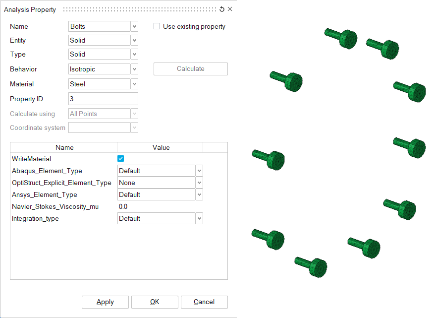

Create a property for the Bolts.
- In the modeling window, select the Bolts.
- In the Analysis Property dialog, enter the values as shown below and click OK.
Figure 7. Bolts Property

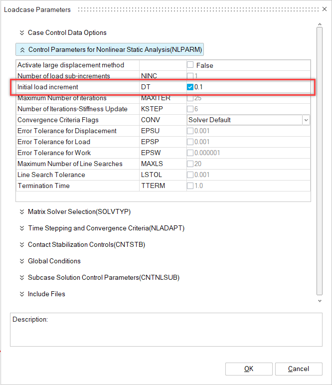

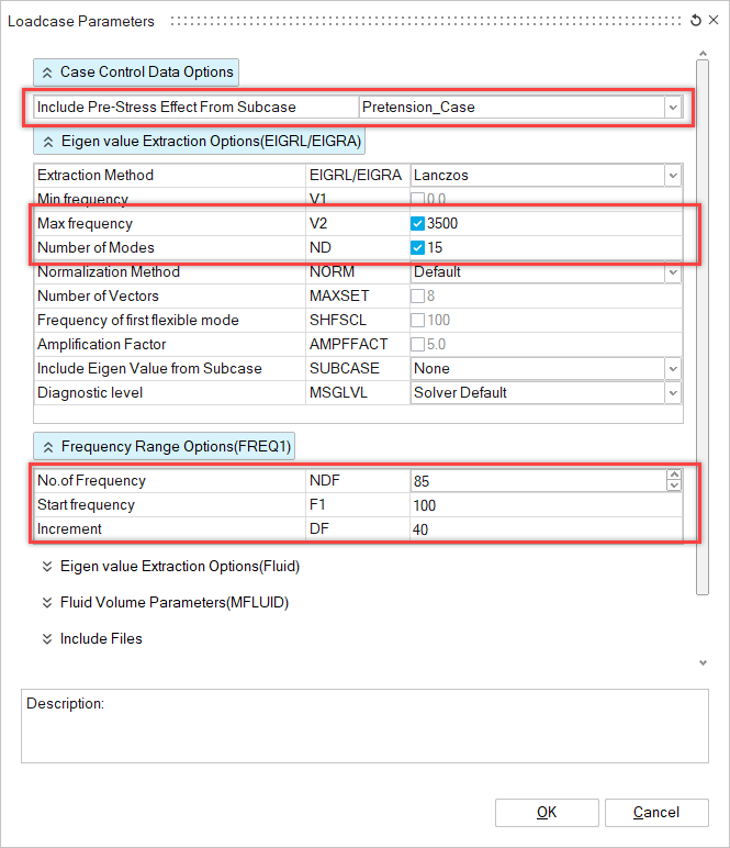

Define Loadcase Parameters
In the Solutions tab of the Model Browser, right-click
the Pretension_Case loadcase and select
Loadcase Parameters from the context menu.
The Loadcase Parameters dialog opens.
In the Loadcase Parameters dialog, enter the values as
Figure 11. Loadcase Parameters Non Linear Analysis

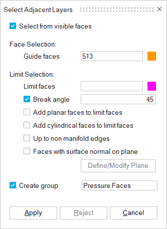

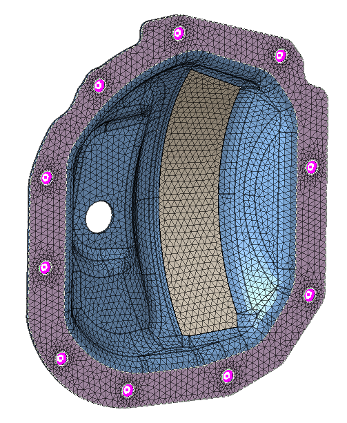

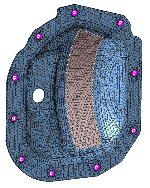

Create Face Group for Pressure Load
Multiple faces must be selected to create a pressure load on the inner face of the cover body.
In the modeling window, select the face in the cover
body.
Figure 12. Select Face
Right-click in the modeling window and select
Select Adjacent Layers from the context menu.
The Select Adjacent Layers dialog opens.
In the Select Adjacent Layers dialog, enable the
Create group checkbox and enter the name as
Pressure Faces.
Figure 13. Create Group of Faces
In the modeling window, select the limit faces and
click Apply in the
Select Adjacent Layers dialog.
Figure 14. Select Limit Faces
Create Pressure Load
- From the Analysis ribbon, Loads and Constraints group, click the Loads tool.
From the secondary tool set, select the Pressure
tool.
The Pressure dialog opens.
In the Pressure dialog, enter the values as shown
below.
Figure 15. Pressure Load Input
- In the Group tab of the Model Browser, select the Pressure_Faces group and click OK in the Pressure dialog.

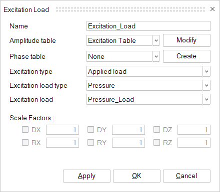

Create Excitation Load
From the secondary tool set, select the Excitation
tool.
The Excitation Load dialog opens.

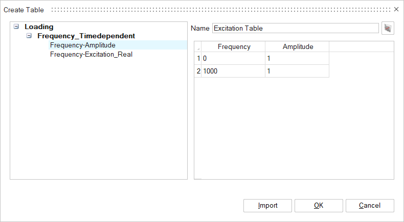

In the Excitation Load dialog, click
Create next to Amplitude table.
The Create Table dialog opens.
In the Create Table dialog, select
Frequency-Amplitude as the Loading Typer, enter the
values as shown below, and click OK.
Figure 16. Define Amplitude Table for Excitation Load
In the Excitation Load dialog, enter the values as shown
below and click OK.
The Pressure_Load defined will automatically be set as the Excitation load.
Figure 17. Excitation Load Input

Define Loadcase Parameter and Result Request
on the Preloaded_MFreq loadcase and select
Figure 18. Loadcase Parameters Frequency Response Analysis

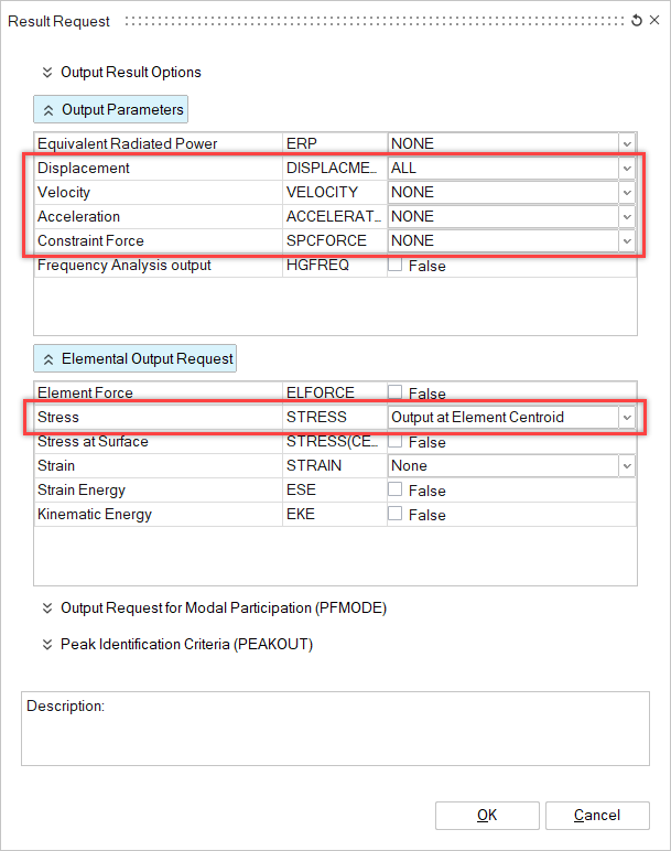

Right-click on the Preloaded_MFreq loadcase and select
Result Request from the context menu.
The Result Request dialog opens.
In the Result Request dialog, enter the values as shown
below and click OK.
Figure 19. Result Requests for Frequency Response Analysis

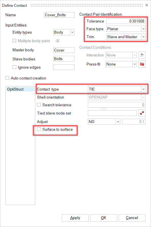

Create Cover_Bolts contact.
- In the Define Contact dialog, enter the values as shown below.
- In the modeling window, select the Cover for the main body and select the Bolts for the secondary body.
- In the Define Contact dialog, click Apply.
Figure 20. Contact Between Cover and Bolts

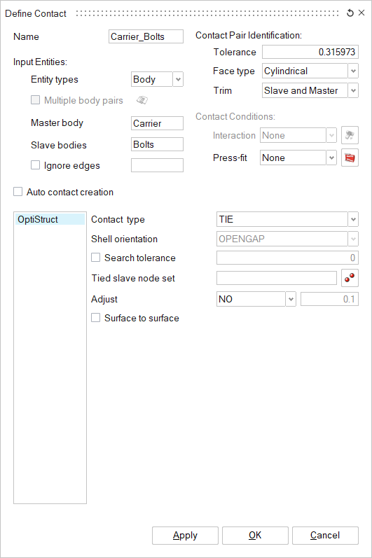

Create Carrier_Bolts contact.
- In the modeling window, select the Carrier for the main body and select the Bolts for the secondary body.
Figure 21. Contact Between Carrier and Bolts

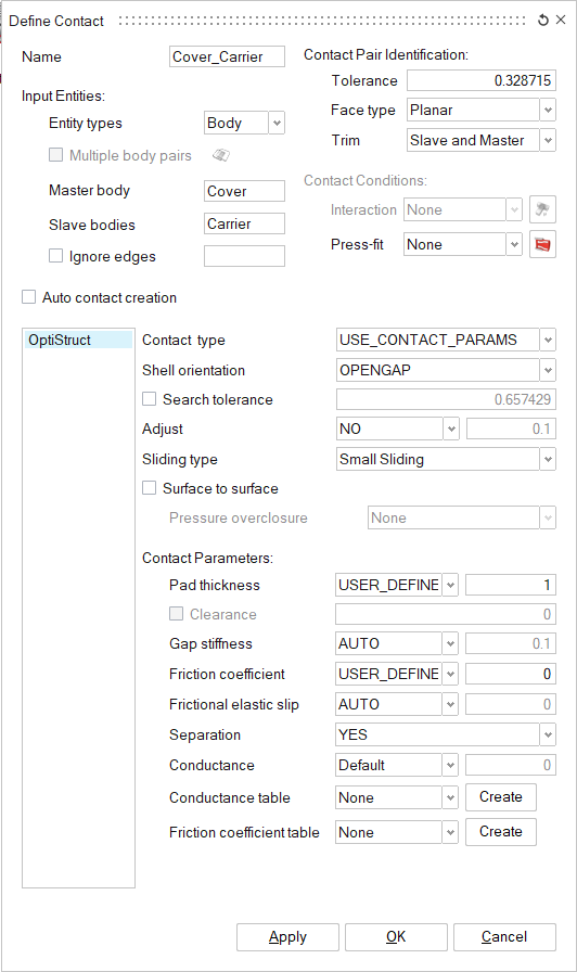

Create Cover_Carrier contact.
- In the modeling window, select the Cover for the main body and select the Carrier for the secondary body.
- In the Define Contact dialog, click OK.
This contact is created to prevent the overlapping of Carrier and Cover bodies.Figure 22. Contact Between Cover and Carrier

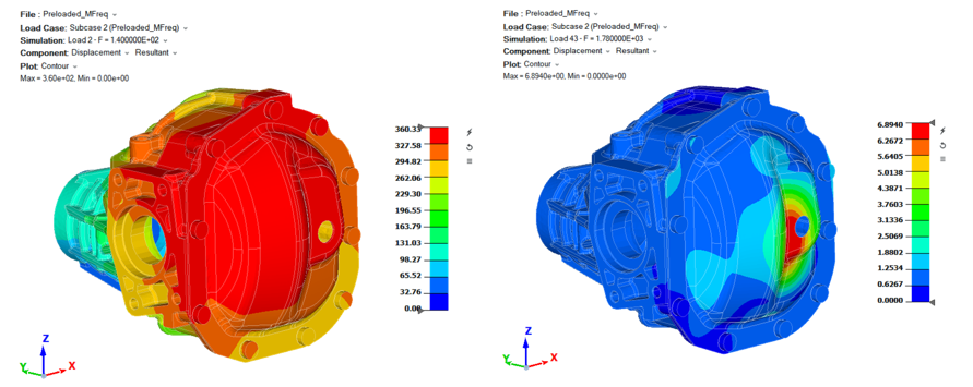

After the model setup has been successfully solved, the results are automatically appended to the input model.
In the Results panel, change the Load Case to view the
results of the Preloaded_MFreq loadcase.
The Simulation of Results panel lists all the frequencies for which the results are computed.
Figure 23. Change Loadcase
- Use the Results panel to change the result component.

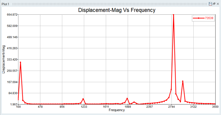

Plot Graph
In this step you will plot a graph of resultant displacement at different frequencies of the Preloaded_MFreq subcase.
From the Results ribbon, Results
group, click the XY Plot tool.
The X Y Plot dialog opens.
In the X Y Plot dialog, change the Data type to
Loadcase/Frequency.
Figure 25. Change Data Type

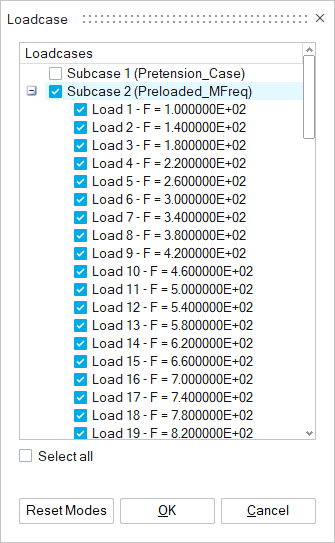

For X Data, click Loadcase.
The Loadcase dialog opens.
In the Loadcase dialog, enable the checkbox for
Subcase2 (Preloaded_MFreq) and click
OK.
Figure 26. Select Subcase to Plot Graph
In the modeling window, select any node from the model
and click Plot in the X Y Plot
dialog.
Figure 27. Example Graph
