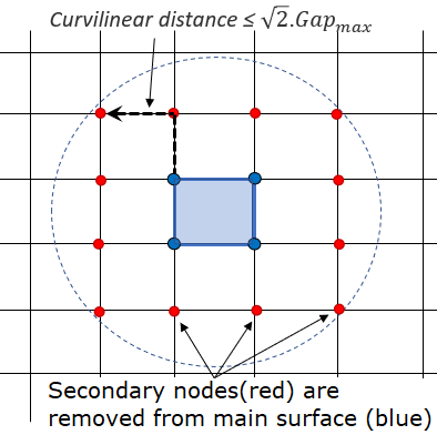

- With Irem_gap = 2, it allows to have the element size smaller than gap values:
Figure 5. Secondary nodes removed from node to surface contact
For self-impact contact, when Curvilinear Distance (from a node of the main segment to a secondary node) is smaller than (in initial configuration), this secondary node will not be taken into account by this main segment, and it will not be deleted from the contact for the other main segments.
