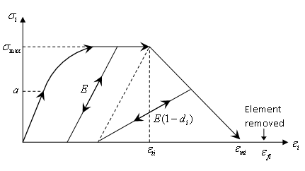

  6. When principal strain ε i becomes higher than ε t i , then damage between ε t i and ε f i is controlled by the damage factor d i , which is given by the following equation.
    d i = min ( ε i ε t i ε m i ε t i ,   d max i ) MathType@MTEF@5@5@+= feaagKart1ev2aaatCvAUfeBSjuyZL2yd9gzLbvyNv2CaerbuLwBLn hiov2DGi1BTfMBaeXatLxBI9gBaerbd9wDYLwzYbItLDharqqtubsr 4rNCHbGeaGqiVu0Je9sqqrpepC0xbbL8F4rqqrFfpeea0xe9Lq=Jc9 vqaqpepm0xbbG8FasPYRqj0=yi0dXdbba9pGe9xq=JbbG8A8frFve9 Fve9Ff0dmeaabaqaciGacaGaaeqabaWaaeaaeaaakeaacaWGKbWaaS baaSqaaiaadMgaaeqaaOGaeyypa0JaciyBaiaacMgacaGGUbWaaeWa aeaadaWcaaqaaiabew7aLnaaBaaaleaacaWGPbaabeaakiabgkHiTi abew7aLnaaBaaaleaacaWG0bGaamyAaaqabaaakeaacqaH1oqzdaWg aaWcbaGaamyBaiaadMgaaeqaaOGaeyOeI0IaeqyTdu2aaSbaaSqaai aadshacaWGPbaabeaaaaGccaGGSaGaaeiiaiaadsgadaWgaaWcbaGa ciyBaiaacggacaGG4baabeaakmaaBaaaleaacaWGPbaabeaaaOGaay jkaiaawMcaaaaa@5430@ in directions, i = 1, 2.
    Stress is reduced according to damage parameter σ i r e d u c e d = σ i ( 1 d i ) . Damage is reversible between ε t i and ε f i . When ε i > ε f i , damage is set to d max i and it is not updated further.
    mat_law27_tensile
