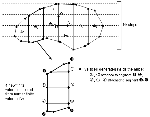

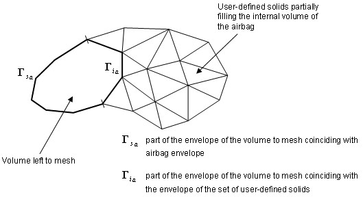

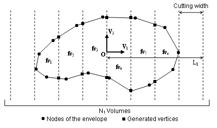

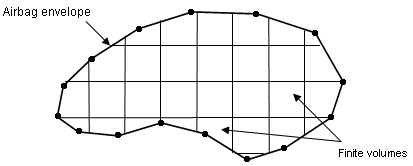

  5. The gas flow in FVMBAG1 is solved using finite volumes.
    Some of these finite volumes can be entered by you through a group of solids, located inside the airbag and filling a part or the total internal volume. If there still exists a part of the internal volume which is not discretized by user-defined solids, an automatic meshing procedure produces the remaining volumes. This can be used for example to model a canister.
    A finite volume consists in a set of triangular facets. Their vertices do not necessarily coincide with the nodes of the airbag. The airbag envelope can be modeled with 4-node or 3-node membranes; however, 3 nodes are recommended.
    monvol_airbag-env
    monvol_airbag2

  18. The finite volumes are generated in two steps.
    • The first step generates vertices lying exclusively on the envelope of the airbag. You can update the finite volume along with the deformation of the envelope and correspond to the following procedure (displayed in 2D for purpose of clarity):
      Figure 4.
      monvol_step1
      This procedure requires the input of the direction V 3 , named cutting direction, and of the direction V 1 . A second direction V 2 in the plan normal to the cutting direction will be computed. In order to position the finite volumes and to determine the cutting width in both direction V 1 and V 2 , an origin O must be provided as well as a length Li, counted both positively and negatively from the origin, and a number of steps Ni. The cutting width is then given by:
      W i = 2 L i N i
      It is required that the box drawn in the horizontal plane (normal to V 3 ) by the origin O and the length Li, counted both positively and negatively from O, includes the bounding-box of the envelope of the volume to mesh projected in this plane. This is necessary to ensure that this volume in entirely divided into finite volumes.
    • The second step performs horizontal cutting of the finite volumes, and may be useless in many cases of tightly folded airbags. It is required especially when injection is made in a canister filled by the injected gas before unfolding the airbag.
    This second step may generate vertices located inside the airbag. In order for them to be moved along with the inflation of the airbag, each is attached to a vertical segment (parallel to direction V 3 ) between two vertices lying on the envelope of the airbag (Figure 4). The local coordinates of the vertex within its reference segment remain constant throughout the inflation process.
    Figure 5.
    monvol_fvmbag
    The horizontal cutting width is given by:
    W 3 = 2 L 3 N 3
    It is not necessary that the segment given in the V 3 direction by the origin O and length L3, counted both positively and negatively, includes the bounding-box of the envelope of the volume to mesh projection on the V 3 direction, since at the second step only existing finite volumes are cut.
