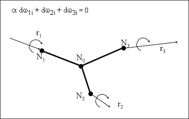

This joint is used to impose rotational velocity relations between an input node and two output
nodes as:Figure 3. Differential Joint Type
The rotational velocities of a differential gear joint are constrained by the
relations:
