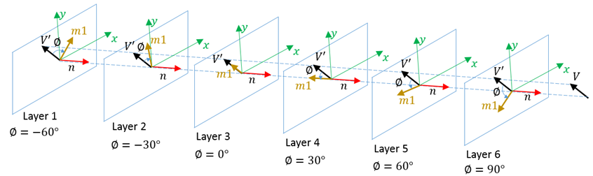

Example
Figure 1. 6 Layers with Different Material Direction (Fiber Direction)
prop_type10_example

  8. The orthotropy angle is defined as following from the reference vector defined in the stack:
    ϕ   =   ϕ s + ϕ i + ϕ + θ d r a p e
    Where,
    ϕ i
    is defined per ply in stack
    ϕ s
    is defined on the element
    ϕ
    is defined on the ply
    ϕ d r a p e
    is defined in the drape table
