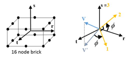

- Thickness direction:
- By default, the element must be oriented so that the thickness direction of the thick shell is in the elements "s" direction.
- However, when using Isolid=14 (HA8), a different thickness direction can be specified using the
constant stress flag, Icstr. Note: Check the elements local system orientation using a pre-processor.
- r, s, t
- Isoparametric frame
- r
- Center of (1, 2, 6, 5) to center of (4, 3, 7, 8)
- s
- Center of (1, 2, 3, 4) to center of (5, 6, 7, 8)
- t
- Center of (1, 4, 8, 5) to center of (2, 3, 7, 6)

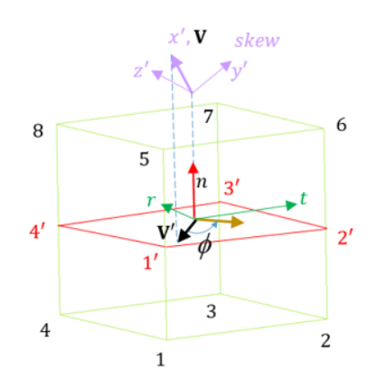

- Othotropy in local coordinate
system.
- The thick shell orthotropy is planar and the third orthotropy direction is coincident with the normal to the shell plane.
- Global vector or skew_ID is used to define the othotropy direction.
is the angle between the first direction of
orthotropy and projection of reference vector on the shell mean plane (r
and t). It is given in degrees.
Figure 3.
