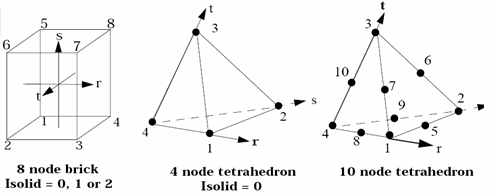

- Isoparametric systems
(r-s-t)For 8 node bricks (Isolid =1 or 2), 4-node tetrahedron and 10-node tetrahedron, the orthotropic system rotates like the orthogonalized isoparametric system. Attention must be paid to the orientation of the orthotropic system in case of large shear.
Figure 3.
r, s, t: isoparametric frame
r: center of (1, 2, 6, 5) to center of (4, 3, 7, 8)
s: center of (1, 2, 3, 4) to center of (5, 6, 7, 8)
t: center of (1, 4, 8, 5) to center of (2, 3, 7, 6)Figure 4.

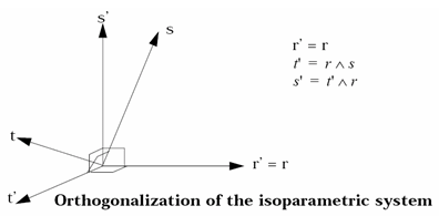

directionFor 3D solid elements, there are three different ways to define orthotropy direction:

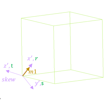

- With Ip= 0 and
skew_ID ≠ 0, skew is used.
Then no reference plane is used; skew is taken directly as the orthotropic system (in this case r =x, s =y, and t =z). x-direction is orthotropy direction 1 and y-direction is orthotropy direction 2.

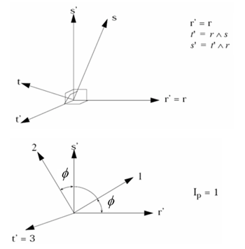

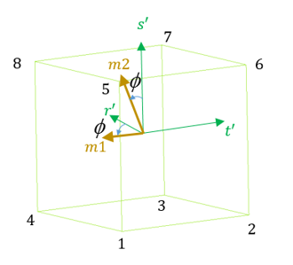

- With Ip = 1, 2 or
3, orthogonalized isoparametric system (r’-s’-t’) and orthotropic
angle are used:The orthotropic system initial orientation (1-2-3) is defined with respect to the initial orthogonalized isoparametric system (r’-s’-t’), as:
Figure 5.
Figure 6.
In this case, the orthotropic system initial orientation is defined the same way as for bricks, Isolid = 0, 1 or 2 (that is with respect to the orthogonalized isoparametric system), and knowledge of the co-rotational system orientation is unnecessary to input the orthotropic system initial orientation.

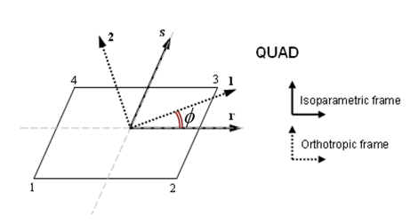

For 2D solid elements (/QUAD), there are two different ways to define orthotropy direction:- With Ip = 1, isoparametric system (r-s) and orthotropic angle are used. 10
- With Ip = 11, Reference vector is used: Global vector may be used to define the orthotropy direction. If this reference vector is orthogonal to plane, first axis of the plane (r-s) is taken as orthotropy direction.
- With Ip= 0 and
- orthotropic angle
For 2D solid elements (/QUAD):
Orthotropic angle is defined with respect to the first direction of the isoparametric frame (r-s).Figure 7.
