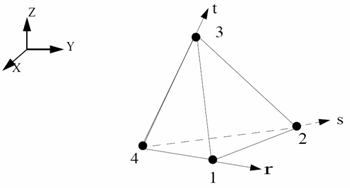

/TETRA4
Block Format Keyword Describes a tetrahedral solid element with 4 nodes.
Format
| /TETRA4/part_ID | |||||||||
| tetra_ID | node_ID1 | node_ID2 | node_ID3 | node_ID4 | |||||
Definition
| Field | Contents | SI Unit Examples |
| part_ID | Part
identifier of the block. (Integer, maximum 10 digits) |
| tetra_ID | Element identifier. (Integer) |
| node_ID1 | Node
identifier 1. (Integer) |
| node_ID2 | Node
identifier 2. (Integer) |
| node_ID3 | Node
identifier 3. (Integer) |
| node_ID4 | Node
identifier 4. (Integer) |
Comments
- The identifier must be unique in each element family, but it is advised for each element type to have a unique element identifier in the global model.
- The part_ID of the tetrahedral 4-node elements must be
different from:
- the part_ID of the brick element
- the part_ID of the tetrahedral 10-node element
