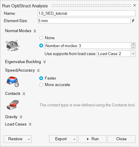

Click Run Analysis
on the Analyze icon to open Run Analysis window.
Tip: To find and open a tool, press Ctrl+F. For more information, see Find and Search for Tools. -
Run a normal modes analysis using the following settings:
- Change the Element size to 5 mm.
- Set the number of Normal Modes to 3 and use the supports from Load Case 2.
- Make sure Speed/Accuracy is set to Faster.
- Click Run to perform the analysis.

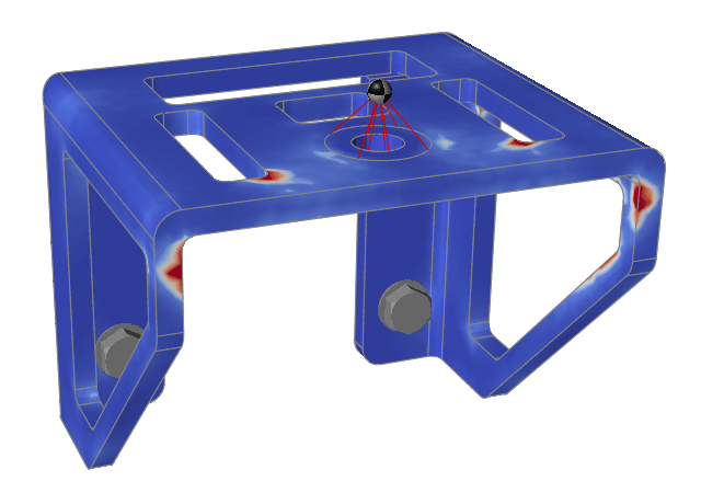

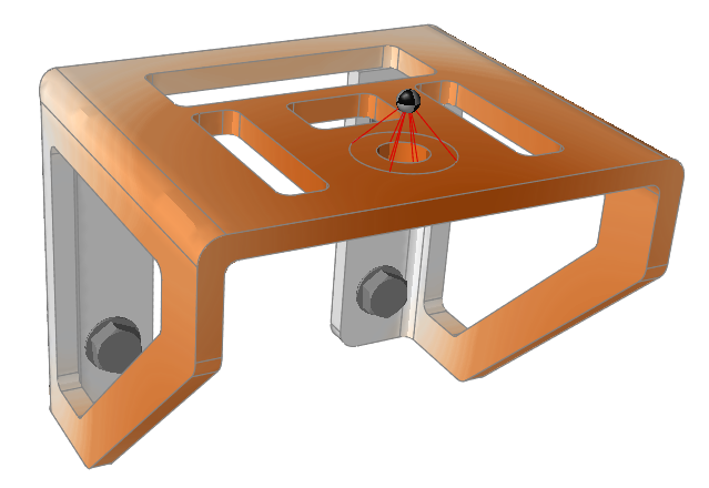

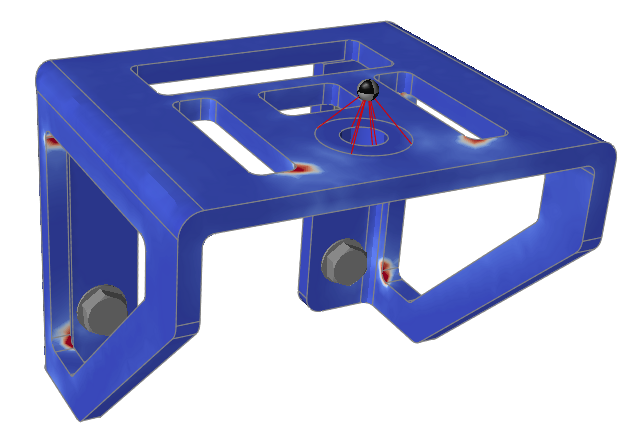

- Animate the displacement result for the first normal mode. Note that although the mode shape is clear, it is difficult to know which parts of the structure are most critical.
Change the result type to Strain Energy Density and
change the legend maximum to 1.0e8 kg/(mm*s2).
This highlights the areas of the structure with the highest relative strain.
Adding material to these high strain regions is normally a good way to increase
the natural frequency.

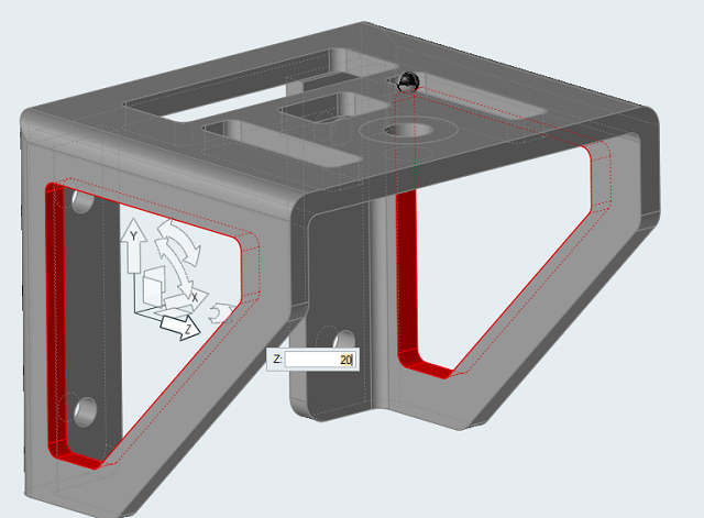

Add Material to the High Strain Regions

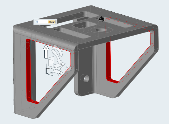

- On the Geometry ribbon, select the Move Faces tool.
Translate the large side cutouts 20 mm in the Z
direction.
Translate the large side cutouts 10 mm in the Y
direction. This adds material to the area of high strain energy density without
changing the mass of the design.

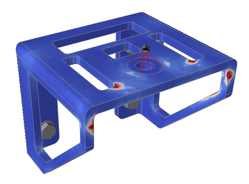

- Re-run the modal analysis (or open the 1.0_SED_tutorial.stmod file in the Demo Browser and load the analysis results.) Note the first frequency has increased.

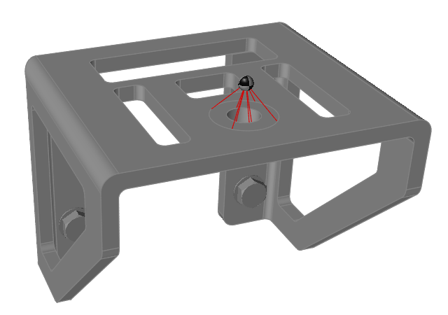

Now translate the two slots on the top of the bracket outwards by 10
mm. The purpose of this change is to increase the bending
section near the areas of high strain energy density on the top of the
bracket.
1.1_SED_tutorial.stmod file in the Demo Browser and
load the analysis results.) Note the first frequency has again increased
significantly.
