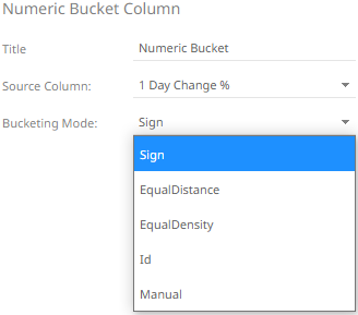

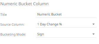

  3. Select the numeric Source Column.
  4. Select Sign in the Bucketing Mode drop-down list box.

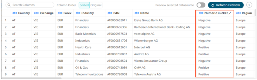

  5. Click  . The new numeric sign bucket column is added and displayed in the Data Preview.
