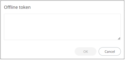

Clicking
for the first time, or if the offline token is expired, you can enter it in the Offline Token dialog that displays.
Consequently, the offline token is cached at the AppData repository for subsequent usage.URL
