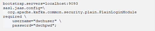

- Enter the External Settings to support authentication (i.e., username and password). Note that if the bootstrap server is not secure, then there is no need to authenticate, and you may leave this text box blank.
Below is an example of system settings for an SASL authentication:

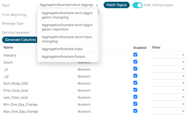

.The first topic in the Topic drop-down list is selected and the schema is displayed.
By default, the Hide Internal Topics toggle button is enabled, and the Avro message type is selected.

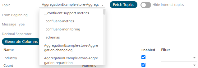

Tap the slider to turn it off. The internal Kafka topics are also displayed in the drop-down list.
- Click the drop-down list to search and select the desired topic.

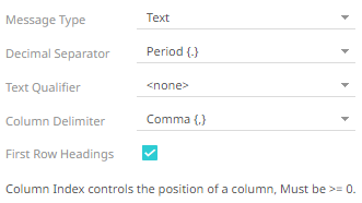

- If Text is selected, confirm the Decimal Separator, Text Qualifier, Column Delimiter, and if the first row of the message includes column headings.
Property Description Text Qualifier
Specifies if fields are enclosed by text qualifiers, and if present to ignore any column delimiters within these text qualifiers.
Column Delimiter
Specifies the column delimiter to be used when parsing the text file.
First Row Headings
Determines if the first row should specify the retrieved column headings, and not be used in data discovery.

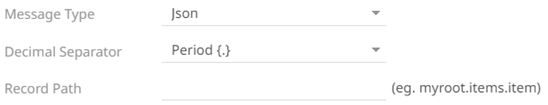

- If JSON is selected, enter the Record Path which allows the identification of multiple records within the JSON document (e.g., myroot.items.item).
Property Description Record Path
The record path that will be queried by the connector’s path (e.g., myroot.items.item).

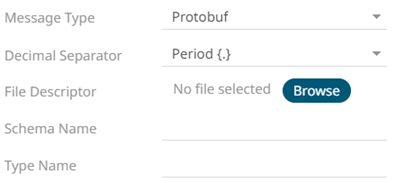

- If Protobuf is selected, confirm the Decimal Separator, and enter the Schema Name and Type Name.
Then click
to select the File Descriptor (.desc file) in the Open dialog.
Property Description Schema Name
The Protobuf schema.
Type Name
The message of Protobuf type that will be sent to Kafka.
File Descriptor
The FileDescriptorSet which:
Is an output of the protocol compiler.
Represents a set of .proto files, using the --descriptor_set_out option.

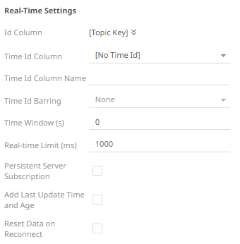

- For this section:
Refer to Define Real-Time Settings for more information.
