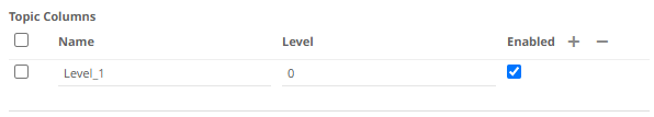

  9. Text for topic levels can be consumed as additional columns into the data table.
    The Topic Columns section shows and allows defining data table columns and mapping them to topic hierarchy levels (index based on left, 0 based).
    Like columns from message data, manually add them by clicking . A new entry displays.
    Name can be any unique topic level within the topic name. The Level is the hierarchy level of the topic column.
    Select the Enabled checkbox to enable a topic column.
    To delete a column, check its  or all the column entries, check the topmost , then click .
