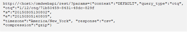

- Enter the OneTick Cloud WebAPI URL into the WebAPI URL box with the following form:
Where:
- s, e, timezone – the start and end time of the query YYYYMMDDhhmmss form. The timezone used to interpret this value is taken from the timezone parameter.
- response – the supported response format is csv.
- compression – if available, this option enables gzip compression of the results stream. Large data should always be pulled with compression on.
