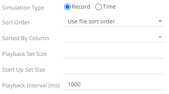

- Select the Simulation Type:
- Record
Sends the number of records for each interval of time. By default, records are sent in the same order as the source.
This simulation type allows the specification of the following:
- Sort Order
When you select Use file sort order, it will use the default sorting order of the file.
When you either select Ascending or Descending as the Sort Order, this enables the Sorted by Column drop down list.
Select the column that will be used for the sorting.
- Playback Set Size
The number of records set to be updated during simulate/playback.
- Start Up Set Size
The number of records set to be published initially (on start-up).
- Playback Interval (ms)
The update interval period for the record-based playback. Default is 1000 (ms).
