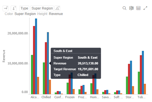

Details Variable Configuration

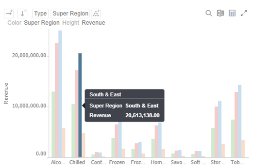

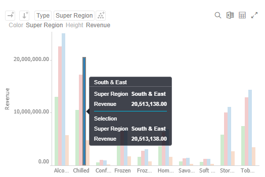

The Details variable controls the information that appears on the pop-up when hovering over a specific item within a visualization. It also controls the information available for export from the visualization.
You can also control whether the following items are displayed or hidden in the Details pop-up:

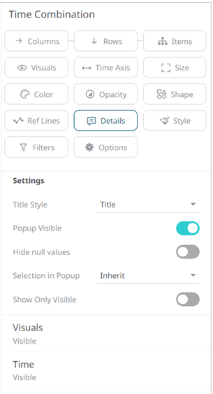

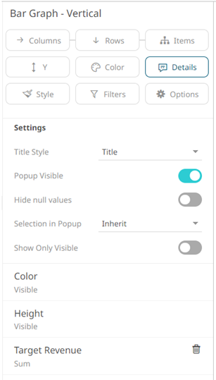

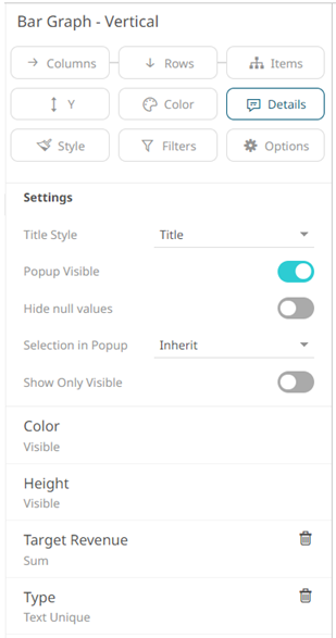

- Click the Details button of a visualization. The Details Settings pane displays along with the available variables of the visualization.

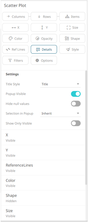

Sample 1: Scatter Plot visualization has HeightX, HeightY, Size, Color,Opacity, Shape, and Reference Lines variables.

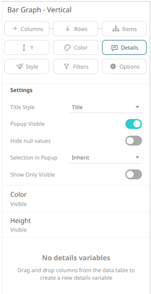

Sample 2: Bar Graph – Vertical visualization has HeightY and Color variables.

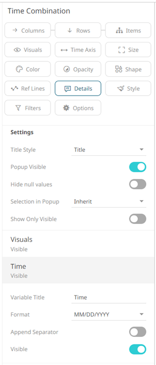

Sample 3: Time Combination visualization has Visuals and Time variables.

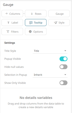

Sample 4: Gauge visualization has the Tooltip variable.
- Select the Title Style: Title, Visible Path, or Full Path.
- By default, Popup Visible is enabled to display the Details pop-up. Tap the slider to turn it off.
- Tap the Hide Null Values slider to turn it on.

- Tap the Show Only Visible slider to turn it on. This means that only the variables that are marked as visible in the tooltip or graph will be displayed in the list.

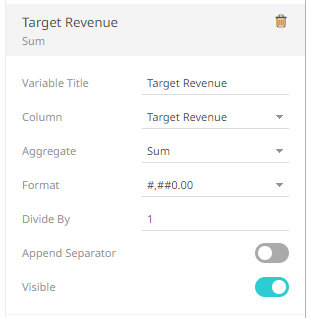

- You can also drag and drop numeric columns from the Data Table pane to the Details
button or on the Details pane.
The column is added under the Details pane.
- Click on the column to display the configuration pane.
- Enter the label of the Details variable in the Variable Title field.
You can parameterize the variable title to support dynamic schema in the dashboards.
- You can opt to change the column to the be used from the Column drop-down list.
- Specify an aggregation method in the Aggregate field.
The default is Sum.
The Details variable also supports several other aggregate types:

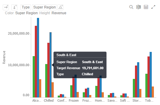

- You can also drag and drop text columns from the Data Table pane to the Details

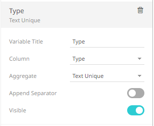

- You can also change the column to the be used from the Column drop-down list.
- Select the text aggregation method from the Aggregate field: Count Distinct, Text Unique (default), or Text Concat Distinct.
- The Format field lets you specify the format that the text will be displayed in. Panopticon uses the same formatting rules as Excel.

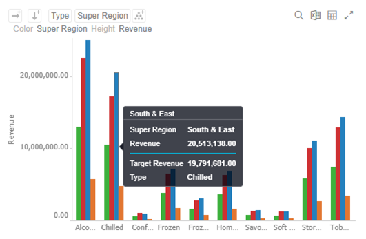

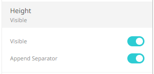

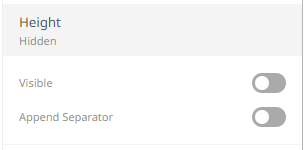

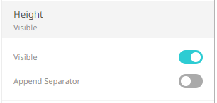

- By default, all of the variables are set to be Visible on the Details pop-up.
For example, when the Height variable column is Revenue and set to Visible, the value of Revenue is displayed in the Details pop-up.
Tap the Visible slider to turn it off so the variable detail will not be displayed.
- Tap the Append Separator slider to display the separator of the values.

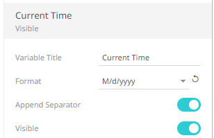

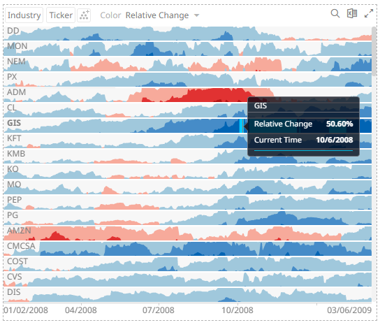

- For time series visualizations, you can set the current time period that will be displayed on the Details pop-up. Otherwise, skip to step 23.
Set the Variable Title and the Format. For example:
