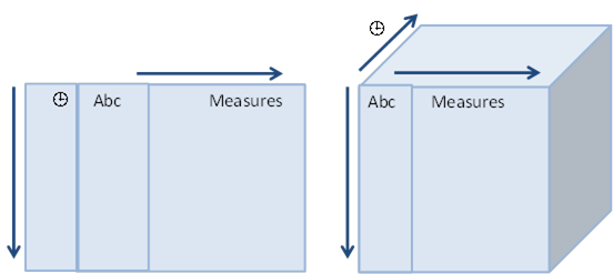

Your source data must be transformed to use time series visualization. The transform converts the dataset into a cube, where the Z axis of the cube represents time, providing a set of time slices to play through and calculate across.

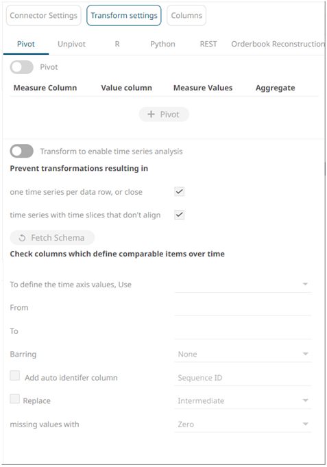

- Click the Transform Settings button. The Transform Settings pane displays.

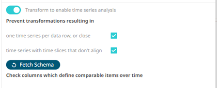

- Tap the Transform to enable Time Series analysis slider to turn it on.
NOTE: Once enabled, the Transform Settings
button displays with a check . If the transform leads to change in the schema, the Fetch Schema
button is also enabled.The check boxes for: one time series per data row, or close and time series with time slices that don’t align, ensure that duplicate values are highlighted, and the time cube volume is minimized.
- Click Fetch Schema
to update columns available for time series transform.
- Select the key or compound key columns from the source list of dimensions to define comparable items over time.
- Select the column to define the time axis values (Date/Time stamp).
Default value is Date.
- Set the Date/Time range of the column set in step 5 in the From and To text boxes.
This filters the time series visualization data causing less data to go over the network to the Web client.
NOTE: The range is not calculated from the start and end values but rather from the Max (the start or the first time slice of the dataset) to Min (the end or the last time slice of the dataset) range. For example, the start and end values can be from 2000-01-01 to 2020-01-01 but the conflation still works as it takes the Date/Time range of the supplied time series.

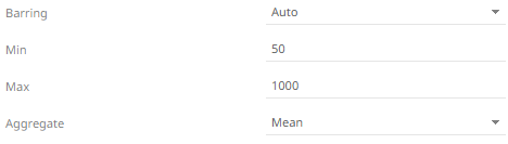

- Choose whether you want to Conflate the dataset by setting the Barring period to Auto, or a defined value, between Year and Nanosecond.
Setting the barring period conflates the dataset to a defined granularity, returning a set number of data points, by default being between 50 and 1000 for Auto.
As data is potentially being aggregated across time, an Aggregate must be selected. The default conflation aggregate is Mean. Other options include: Sum, Min, Max, First, Last and Count.

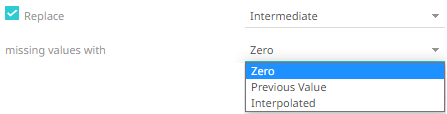

- Choose whether you want to interpolate for missing values.
The interpolation can replace missing numeric values with Zero, the Previous Value, or an interpolation between known values (Interpolated).

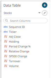

then
to save the data table and exit the Data Table Editor layout. On the Open Workbook in Design Mode, a time series data table is visually identified by the time series curve to the left of any numeric time series fields.
