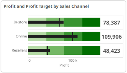

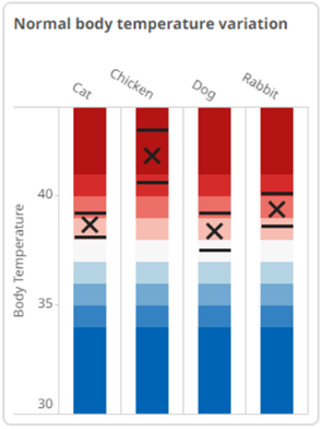

Similar to a bar graph, a gauge serves the purpose of visualizing a specific value by drawing a bar along an axis. However, the gauge is also different from a plain bar graph and can communicate more information, by having one or several reference value indicators, and by having color scale background. Thereby, the viewer immediately understands if the current value is considered low or high, good, or bad, and how far off from a target or a reference value it is.
Here are some examples of the Gauge visualization:

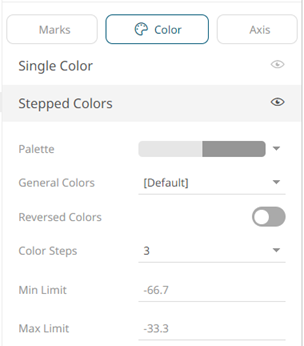

Sub-pill Setting Description
Single Color > Palette
These settings give a uniform, single color to the gauge bar.
Stepped Colors > Palette
These settings give a stepped color coding of the gauge bar, using either a 2-color palette (sequential palette) or a 3-color palette (diverging palette).

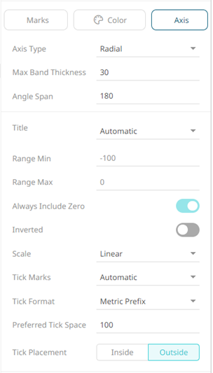

Axis Type
Controls the Gauge type: Radial, Horizontal, or Vertical.
Max Band Thickness
Sets the maximum thickness of the gauge bar. When the screen space is not enough, the band will be drawn thinner. Default is 30 pixels.
Angle Span (for Radial Axis Type only)
Sets the angle of the radial gauge. Values 1-360 supported. Default is 180.
Axis Thickness (for Horizontal and Vertical Axis Type only)
Sets the thickness of the area where axis tick mark labels are showing.
Title
The title of the numeric axis. Options include the following:
  • Automatic - shows the name of the first Mark data column
  • None
  • Custom - any text value entered, or a specific selection of any of the existing Mark data columns
Title Margin (for Horizontal and Vertical Axis Type only)
Sets the width of the space where the axis title is showing.
Range Min and Range Max
The range of the gauge band axis. Automatically set values are showing in gray font, while explicitly set values are showing in black font.
Always Include Zero
Available only when Marks is NOT set to bar. Controls whether zero should always be included in the automatically selected axis range. Default value is On.
Inverted
Makes the gauge go from right-to-left instead of from left-to-right, or from top-to-bottom instead of bottom-to-top in the case of Vertical Axis Type.
Scale
Sets the type of scale to use on the gauge axis. Can be Linear, Power, or Logarithmic. Default is Linear.
Tick Marks
Controls the number of tick marks to show along the gauge axis. Options are Automatic, Custom, or None. Default is Automatic.
Tick Count
Available only when Tick Marks is set to Custom. Controls the number of tick marks to show.
Tick Min and Tick Max
Available only when Tick Marks is set to Custom. Controls the values where tick marks will show.
Tick Format
Controls the formatting of the tick mark labels. Options are Metric Prefix or Custom. Default is Metric Prefix.
Tick Placement (for Radial Axis Type only)
Controls where axis tick marks will show. Can be either Inside (below) the gauge bar or Outside (above) the gauge bar. Default is Outside.
