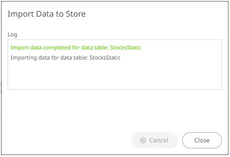

- Do one of the following:

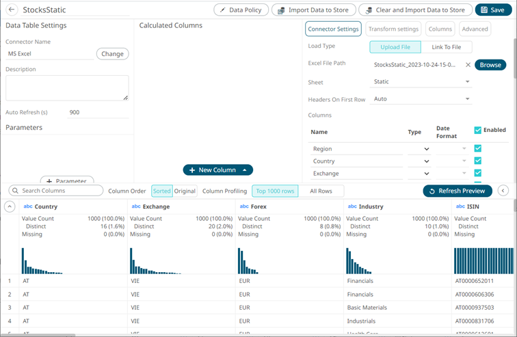

- Select one or more data tables on the Data Library page then click Import to Data Store
- Select a data table to open on Data Table Editor then click
The notification dialog displays that the data table has been imported to the data store.
The icon also changes accordingly:
on the Data Table Editor
