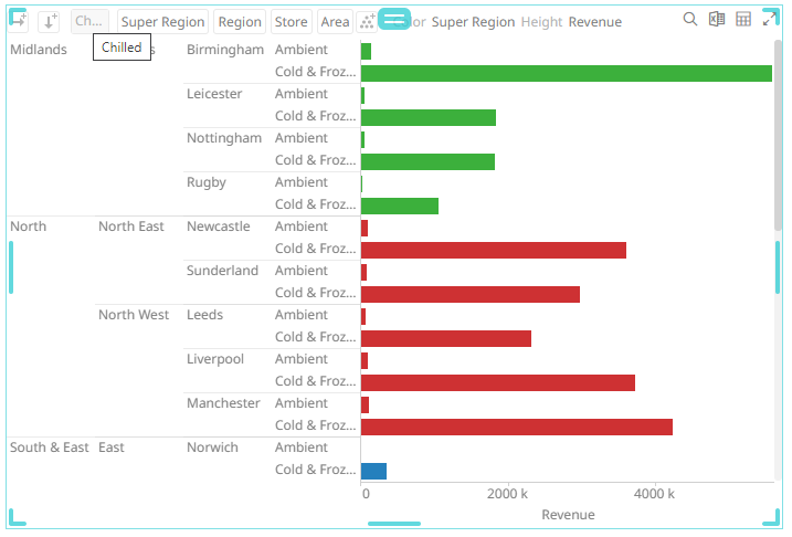

Type > Super Region > Region > Store > Area

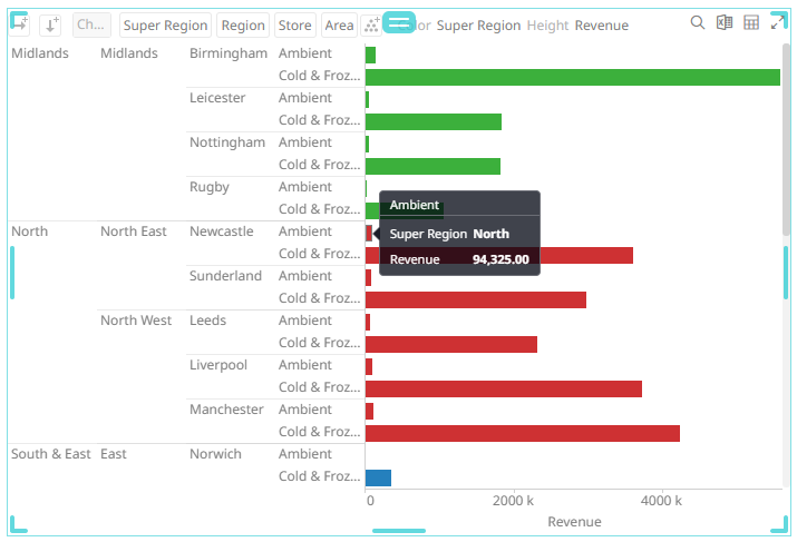

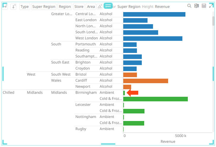

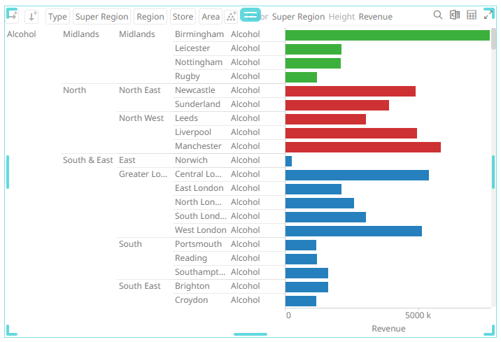

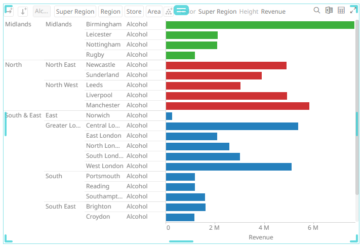

Drilling into the value of the lowest level (Ambient) will grey out the topmost level (Type) displaying only its value (Chilled). Furthermore, the visible details will only display the second to fifth levels (Super Region, Region, Store, and Area):

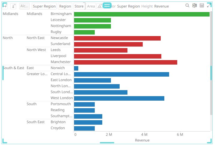

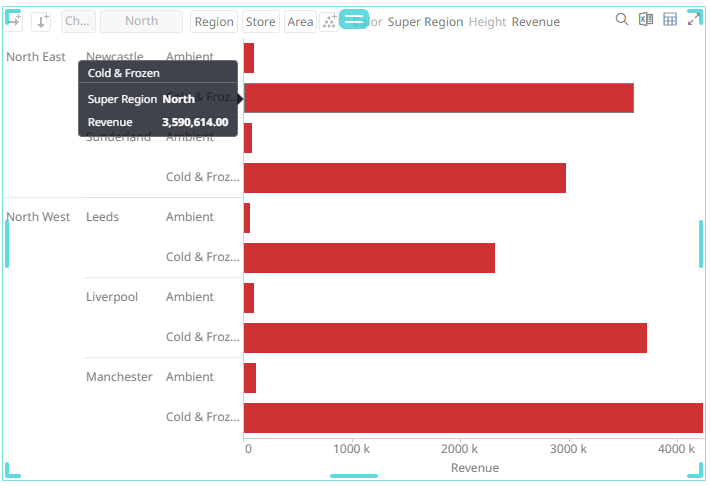

Then drilling into the first Ambient value for the North Super Region level:

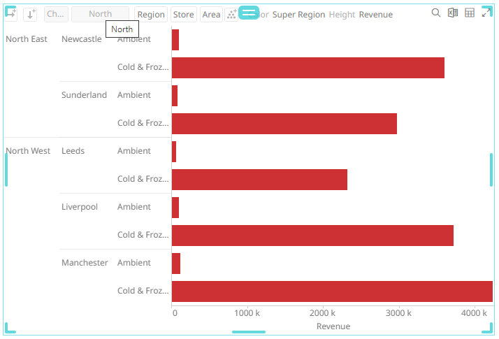

Will grey out the second level (Super Region) displaying only its value (North). Furthermore, the visible details will only display the third to fifth levels (Region, Store, and Area):

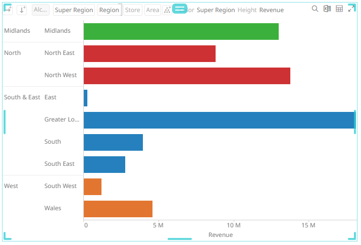

To continue, drilling into the Cold & Frozen value for the North East Region level:
Will grey out the third level (Region) displaying only its value (North East). Furthermore, the visible details will only display the fourth to fifth levels (Store and Area):

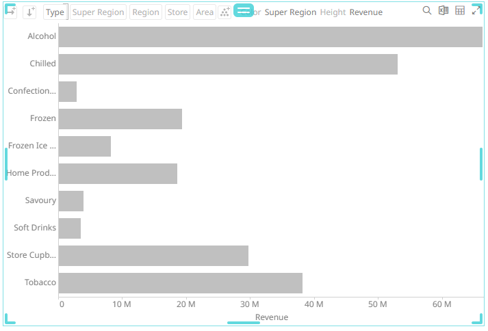

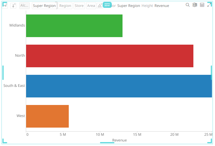

One Level
Only one level will be shown. Initially, the only visible detail will be the topmost level (Type) and the rest of the levels will be greyed out.
Drilling into an area automatically shows the values of the next level (i.e., Super Region).
