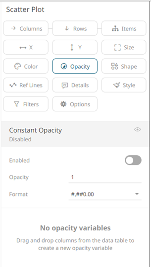

- On the Visualization Settings pane, click the Opacity variable.
You can set the Constant Opacity, if needed.
- Click Constant Opacity to expand its settings.
NOTE: Constant Opacity has a minimum of 0 to maximum of 1 value, and a step of 0.01. The Up and Down buttons have been removed in previous changes to numeric input component, but the mouse wheel can still be used to scroll between values.

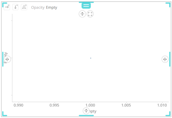

- Tap the Enabled slider to turn it on. Empty currently displays as the associated value of the Opacity variable.
You can opt to modify the following properties:
Property Description Opacity Value
Opacity value of the Opacity variable. The two nearest valid values are 0% and 100%.
Format
Format how numbers will be displayed.

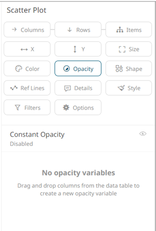

- To associate other columns from the data table, drag and drop them to the Opacity variable drop area. Select one to display the corresponding configuration pane.

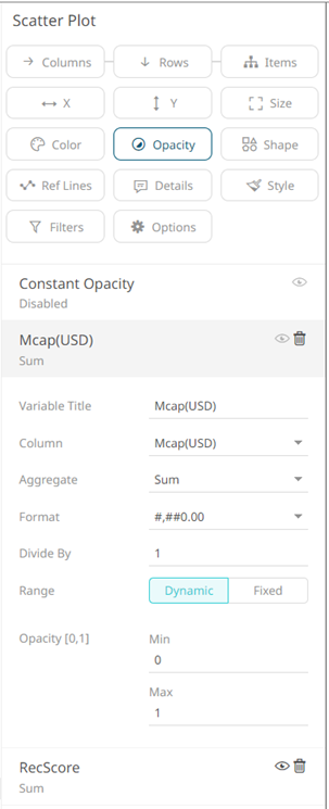

- Enter the label of the Opacity variable in the Variable Title field.
You can parameterize the variable title to support dynamic schema in the dashboards.
- You can also change the column to the be used as the Opacity variable from the Column drop-down list.
- Specify the aggregation method in the Aggregate field.
The default is Sum.
The Opacity variable also supports several other aggregate types:
- If you set the aggregation method to Cumulative Sum or Cumulative Sum by Max, the Sort By drop-down list is enabled and displays a list of numeric data columns in the selected data table that can be used as the sorting column for the aggregate.
Cumulative Sum By Max is, in practice, Cumulative Sum with a setting to use Max as he sort by aggregation.
- If you set the aggregation method to Intercept or Slope, the Y Variable drop-down list is enabled and displays a list of numeric data columns in the selected data table that can be used as the Y-axis variable column for the aggregate.
- If you set the aggregation method to Percent of Parent Reference, Percent of Total Reference, or Ratio of Sums, the Reference Column drop-down list is enabled and displays a list of numeric data columns in the selected data table that can be used as the reference column for the aggregate.
- If you set the aggregation method to Percent of Total Change, the Previous Values Column drop-down list is enabled and displays a list of numeric data columns in the selected data table that can be used as the previous column for the aggregate.
- If you set the aggregation method to Percentile, the Percentile field is displayed. Specify the value that can be used to calculate the value of the selected percentile.
- If you set the aggregation method to Weighted Harmonic Mean, Weighted Mean, Weighted Population Variance, Weighted Stdev, Weighted Stdevp, Weighted Sum, or Weighted Variance, the Weight Column drop-down list is enabled and displays a list of numeric data columns in the selected data table that can be used as the weight column for the aggregate.
- The Format field lets you specify the format that numbers will be displayed in. Panopticon uses the same formatting rules as Excel.
- Select the Divide By value to divide a number:
- 1
- 1000 (by a thousand)
- 10000
- 1000000 (by a million)
- 1000000000 (by a billion)
- The visible range for the Opacity variable can either be calculated dynamically (the default, enabled Dynamic).
Or set between predefined limits by clicking Fixed. This reveals the Min and Max text boxes and populates them with default values taken from the data set.
- Enter the Min Opacity (default 0%) and Max Opacity (default 100%) values.
The Opacity variable takes any numeric column and maps the values to their corresponding Opacity values. Consequently, it calculates the values’ relative position in the domain of the column, and maps that to the same relative position for the domain of the Opacity values.
