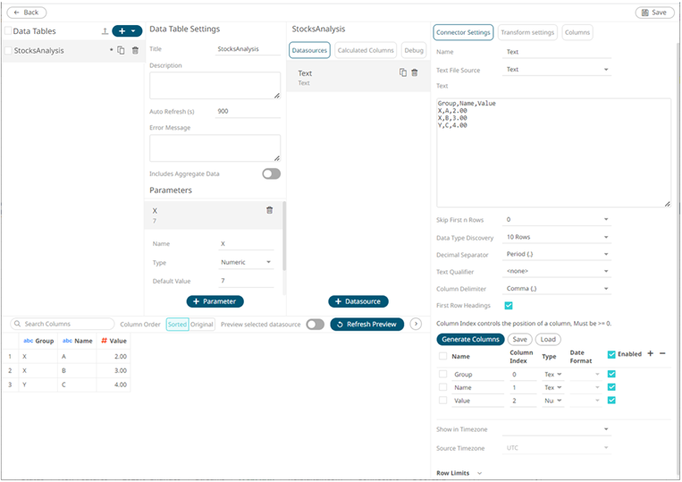

Creating a new numeric parameter X with a value of 7:
Then adding calculated columns AddOne = [Value] + 1 and AddX = [Value] + {X} will result to:

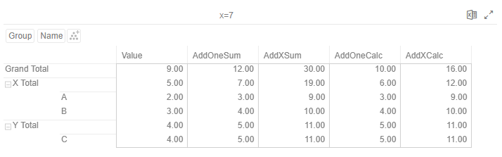

Below is the defined breakdown in a Table visualization:
This Table visualization is showing the grouping of the columns based on the breakdown hierarchy with AddOneSum, AddXSum, AddOneCalc, AddXCalc as Visual Members with the corresponding aggregates and the X value is set to 7:
| Column | Aggregate |
Value |
Sum |
AddOneSum |
Sum |
AddXSum |
Sum |
AddOneCalc |
Calculation |
AddXCalc |
Calculation |

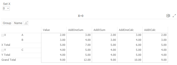

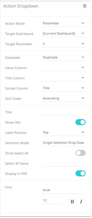

Adding an Action Dropdown in the dashboard with a Set Parameter mode:

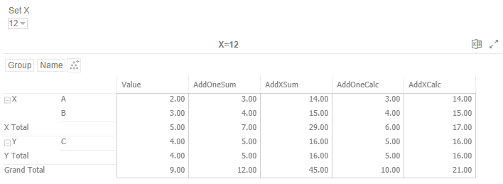

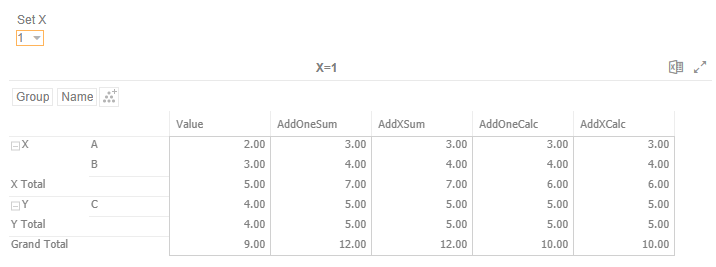

And given Table 2:
| Value |
| 0 |
| 1 |
| 7 |
| 12 |
Will result to these Table values:
