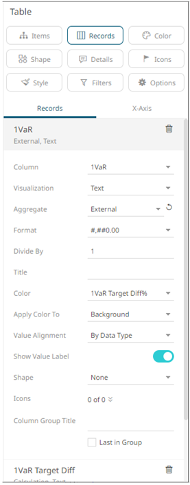

To retrieve external aggregates:
- Retrieve your data set including both base data, plus aggregate data.
- On the Data Table Settings pane, tap the Includes Aggregate Data slider to turn it on and then select the text column that defines the leaf.
- Enter the Value to determine aggregate rows. The default being blank.
- Click the Save
button.
NOTE: Within the visualization, the default aggregation method for all variables will be set to External.
