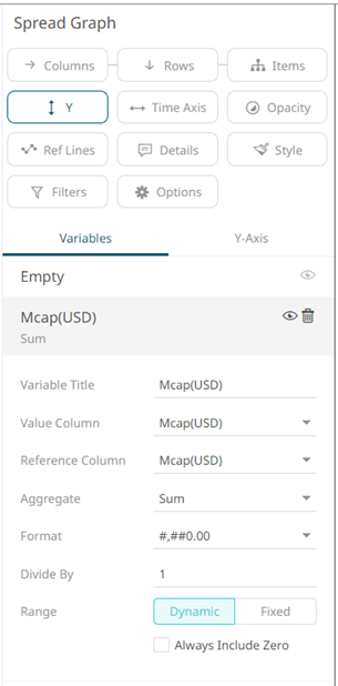

The Spread (Y) variable is available in the Spread Graph visualization.
- On the Visualization Settings pane, click the Spread variable. To associate other columns from the data table, drag and drop them to the Spread variable drop area. Select one to display the corresponding configuration pane.
- Enter the label of the Spread variable in the Variable Title field.
You can parameterize the variable title to support dynamic schema in the dashboards.
- You can also change the column to the be used as the Shape variable from the Value Column drop-down list.
- Select the Reference Column. The difference with the Value Column will be the basis if the variability or spread of the data is positive or negative. For example:

- You can also specify an aggregation method in the Aggregate field.
The default is Sum.

- The Format field lets you specify the format that numbers will be displayed in. Panopticon uses the same formatting rules as Excel.
- Select the Divide By value to divide a number:
- 1
- 1000 (by a thousand)
- 10000
- 1000000 (by a million)
- 1000000000 (by a billion)
- The visible range for the Spread variable can either be calculated dynamically (the default, enabled Dynamic).
Select the Always Include Zero checkbox to let the axis scale start at zero and grow to any number that may show up in the data.
Or set between predefined limits by clicking Fixed. This reveals the Min and Max text boxes and populates them with default values taken from the data set.
