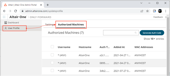

  1. Log on to Altair One (https://admin.altairone.com) then navigate to User Profile and select Authorized Machines

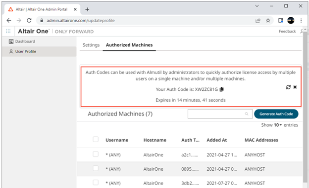

  2. Click  .
    The page displays the auth code and a timer indicating the code’s expiration.
    Click Copy to Clipboard  to copy the generated auth code.
  3. Paste the generated code into the license.hwu.hosted.authorization.token property in the Panopticon.properties file.
