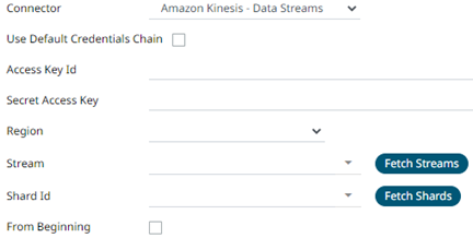

  2. You can either:
    • Select  the Use Default Credentials Chain checkbox to use the default Access Key ID and Secret Key Access, or
    • Unselect the Use Default Credentials Chain checkbox and enter the Access Key ID and Secret Key Access
    NOTE: The Access Key ID and Secret Key Access from the AWS account can be configured in three places:
    • Two properties at the Streams.properties file which is available in the AppData folder of Panopticon Streams
      • connector.kinesis.datastreams.accesskeyid
      • connector.kinesis.datastreams.secretaccesskey
      If this is the used configuration, the Use Default Credentials Chain box is not displayed in the connector UI.
      mmm
      This is the recommended way to provide the credentials.
    • AWS credentials provider chain
      • Environment Variables - AWS_ACCESS_KEY_ID and AWS_SECRET_ACCESS_KEY
      • Credential profiles file at the default location - ~/.aws/credentials on Linux, macOS, or Unix, and C:\Users\USERNAME\.aws\credentials on Windows.
    • Dedicated fields in the connector
      Not the recommended configuration.

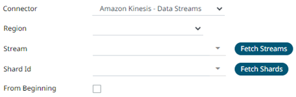

  3. Enter the following information:
    Property Description
    Region
    Physical location of the data center. The list is picked up from the Amazon Kinesis Data Streams Endpoints and Quotas page.
    Stream
    Name of the stream from where you want to pull the data. Click Fetch Streams   to load all of the available streams from the AWS account.
    Shard Id
    Each connector instance or data source is connected to only one shard. Click Fetch Shards   to pull all of the shards from the selected stream.
    From Beginning
    The starting position in the data stream from which to start streaming. Default value is unchecked, which means LATEST. When checked, the starting position is set to TRIM_HORIZON.
