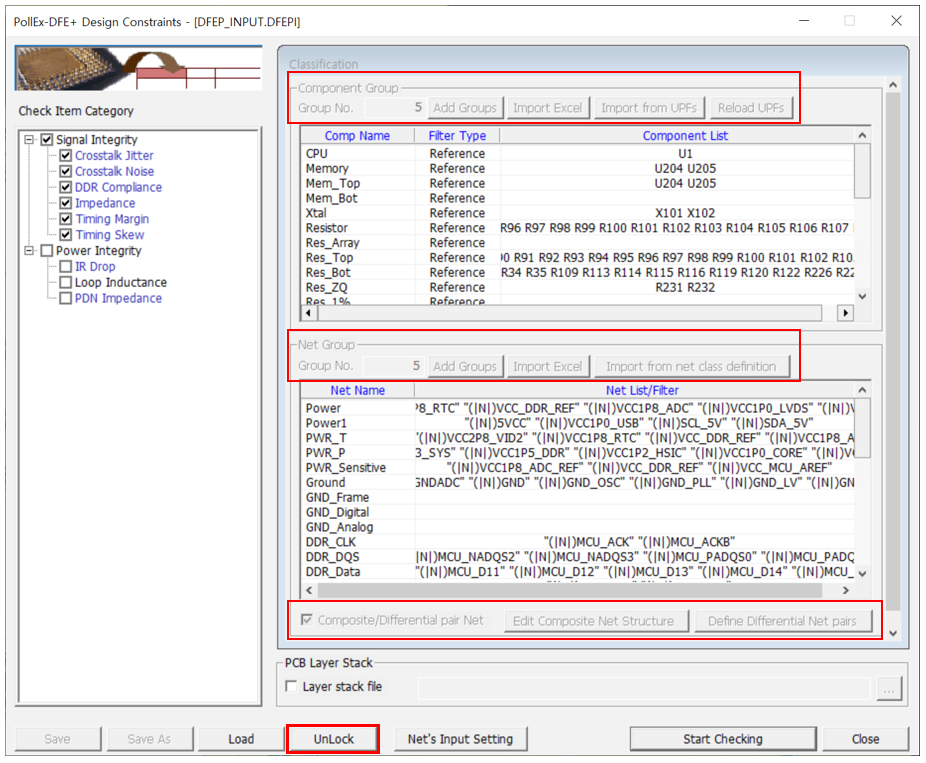

- Use Input File Lock: DFE+ input rule file (*.DFEPI) can be locked to prevent any modifications from users. The purpose of the input file encryption is to keep a uniform set of rules throughout without tweaking them for certain application once the input setup is done by a designated person. Locked DFE+ input file can be used to verify a PCB design and only tweaked by the designated person. If you check the above option, the Lock button in Input dialog is activated and you can specify and save a password as shown in the figure below.

- CompGroups: User can create Component Groups of DFE+ Input using the
information of the parts set by UPF. Then, Click Import from
UPFs in the Input of DFE+ to easily create the Component
Groups.
- Component Group List: This is a name list of Component Groups that will be created in Input. The initial list is provided by the PollEx. You can add and modify it, save or load the entire list.
- UPF Part Classification List: This is the information of the parts set by UPF. If you click on the list of each category, the codes displayed. You can easily classify and create the Component Group by using Add button for these codes. The added code list will display on the Selected Part Classification List section.
