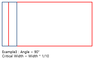

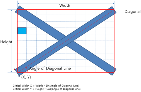

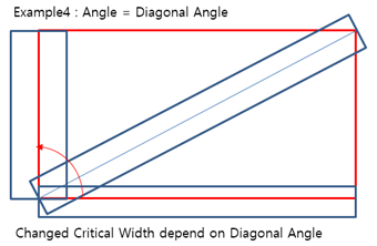

- Diagonal Placed BGA Check: Define the placement of a BGA-type component
after setting the soldering direction. Avoid placing BGA-type components on
the board center or corner.
- BGA Component Group: Enter a BGA component group for analysis.
Figure 2. Critical Area Width or Critical Area Ratio(%)
Figure 3.
Figure 4.
Figure 5. - Warpage Direction Definition: Enter the expected warpage direction
as diagonal or horizontal.
- Horizontal Axis Definition: Select the x-axis or y-axis for the horizontal case.

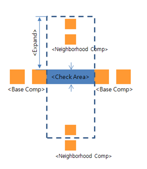

- Placement Direction between Components: Analyze the placement
direction between components placed near each other. Define the base
component, peri-component, and the direction angle for use.
- Base Component: Select a base component for analysis.
- Base Component Distance: Define a distance from the base component for analysis.
- Expand Area: Enter a value for the expansion of the analysis area.
- Peri-component: Select a peri-component for the analysis or select All to check all the components.
- Placement Direction: Define the direction angle of the
peri-component.
Figure 6. Example
