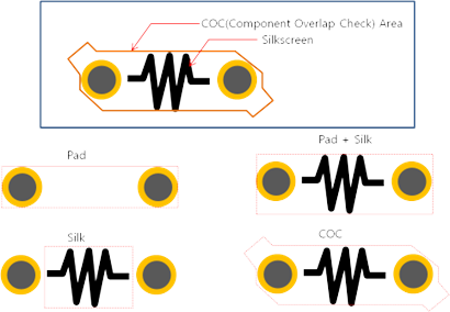

- Checking Area Definition: Set the components area where the
other vias or holes should not be placed.
Figure 1.- COC: Area defined in component overlap check (COC) area.
- Silk: Area including silkscreen.
- Silk + Pad: Area including pad and silkscreen area.
- Pad: Area including pads.
- COC + Pad: Area defined in pad and COC area.
- Center: Check based on the center point of the part.
- Default: Use the component area basement used in the default setup in the Component Classification Setting dialog. If it is undefined in the Component Classification Setting dialog, pad including area will be used as default.

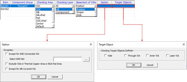

- Component Group Selection: Select the target components as a group
selection from the list.
Figure 3.- Item: Specify the item name.
- Component Group: Select target component group from the list.
- Checking Area: Set the component area where other vias or
Figure 4.- COC: Area defined in COC area.
- Default: Use the component area basement used in the default setup in the Component Classification Setting dialog. If it is undefined in the Component Classification Setting dialog, the pad including area will be used as default.
- Checking Layer:
- All: PollEx DFM checks for top and bottom.
- Component Placed Layer: PollEx DFM checks only for the target component placed layer.
- Basement of Vias: You can set a via measurement base in
measuring distance from a via.
Figure 5.- Position: Via location.
- Shape: Via outer pad shape.
- Hole: Via hole outer size.
- Option
- Except for GND Connected Via: Even if vias are detected by PollEx DFM, if they are ground vias, they do not fail.
- Select GND Net: Select ground net from net list.
- Exclude Vias in Thermal Copper Area or BGA Pad Area: Even if vias are detected by PollEx DFM, if they are vias in thermal copper-pour or under BGA packages pad, they do not fail.
- Except for Silk Covered Via: Exclude via that is covered with Silkscreen.
- Expand Area: Set the clearance area.
- Horizontal: Set the clearance horizontal area.
- Vertical: Set the clearance vertical area.
- Target Objects
- Hole: If holes exist under specified components, PollEx DFM defines them as fails.
- Through Via: If through vias exist under specified components, PollEx DFM defines them as fails.
- Inner Via: If inner vias exist under specified components, PollEx DFM defines them as fails.
- Laser Via: If laser vias exist under specified components, PollEx DFM defines them as fails.
- Padstack String Filter: If using string filter vias exist under specified components, PollEx DFM defines them as fails.
