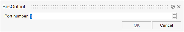

BusOutput
This block adds a bus output port to a super block to connect bus signals inside of the super block to blocks outside of the super block.
Activate/BusOperations
Placed in the diagram of a super block, the BusOutput block adds a bus output port to a super block for linking bus signals inside of the super block to blocks outside of the super block. Any link, outside of the super block, that is connected to the bus output port on the super block extends from the corresponding BusOutput block inside of the super block. The BusOutput block supports regular signals in addition to bus signals.The parameter "Port number" determines the relationship between the port block and the port on the super block. By default, the output ports are numbered sequentially from top to bottom.
