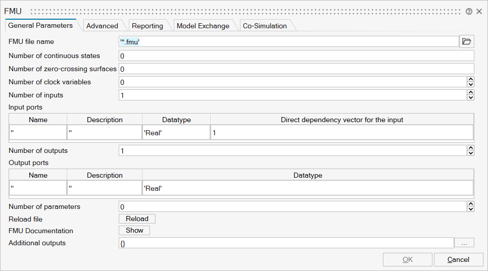

FMUfilename | FMU file name | The full path of the FMU to be imported. | String | |
NX | Number of continuous states | Read-only. Number of continuous-time states of the FMU. Click the 'Reload' button to automatically populate this field. | Scalar | |
NZ | Number of zero-crossing surfaces | Read-only. Number of zero-crossing surfaces of the FMU. Click the 'Reload' button to automatically populate this field. | Scalar | |
nevin | Internal parameter. Number of input events | Number of input event ports of the FMU. Click the 'Reload' button to automatically populate this field. | Number | |
nevout | Internal parameter. Number of output events | Number of output event ports of the FMU. Click the 'Reload' button to automatically populate this field. | Number | |
nclocks | Number of clock variables | Number of clock variables in the FMU. Click the 'Reload' button to automatically populate this field. | Number | |
clocks | Clocks | Table of clocks data. | Structure | |
clocks/name | Name | Read-only. Name of the clock variable. | Cell of strings | |
clocks/description | Description | Read-only. Description of the clock variable. | Cell of strings | |
clocks/causality | Causality | Read-only. Type of causality. | Cell of strings | |
clocks/intervalVariability | Interval Variability | Read-only. Type of clock. | Cell of strings | |
clocks/intervalDecimal | Interval Decimal | Interval (period of clock for periodic clocks) | ||
clocks/shiftDecimal | Shift Decimal | Shift of offset of the clock for perodic variable. | ||
clocks/resolution | Resolution | Internal parameter. Resolution of the clock. | ||
clocks/intervalCounter | Interval Counter | Internal parameter. Interval counter of the clock. | ||
clocks/shiftCounter | Shift Counter | Internal parameter. Shift counter of the clock. | ||
clocks/reference | Reference | Internal parameter. | ||
nin | Number of inputs | Number of input ports of the FMU. Click the 'Reload' button to automatically populate this field. | Number | |
inports | Input ports | Table of inports data. | Structure | |
inports/name | Name | Name of the input port. The name is extracted from the FMU file and is not editable. | Cell of strings | |
inports/description | Description | Description of the input port. The description is extracted from the FMU file and is not editable. | Cell of strings | |
inports/it | Datatype | Input datatype of the input port. The datatype is extracted from the FMU file and is not editable. | Cell of strings | |
inports/dodependency | Direct dependency vector for the input | Input-output dependency of the input port (feedthrough). The dependency is extracted from the FMU file, but it is editable. For each input port, a dependency vector is provided which indicates the output ports that depend on the this input port. In this vector zero(0) means no dependency and one(1) means direct dependency of output on input. | Cell of vectors | |
nout | Number of outputs | Number of output ports of the FMU. Click the 'Reload' button to automatically populate this field. | Number | |
outports | Output ports | Table of outputs data. | Structure | |
outports/name | Name | Name of the output port. The name is extracted from the FMU file and is not editable. | Cell of strings | |
outports/description | Description | Description of the output port. The description is extracted from the FMU file and is not editable. | Cell of strings | |
outports/ot | Datatype | Output datatype of the output port. The datatype is extracted from the FMU file and is not editable. | Cell of strings | |
nparam | Number of parameters | Number of editable parameters of the FMU. Click the 'Reload' button to automatically populate this field. | Number | |
params | Parameters | Table of parameters data. | Structure | |
params/name | Name | Name of the parameter. The name is extracted from the FMU file and is not editable. | Cell of strings | |
params/description | Description | Description of the parameter. The description is extracted from the FMU file and is not editable. | Cell of strings | |
params/tp | Datatype | Parameter datatype of the output port. The datatype is extracted from the FMU file and is not editable. | Cell of strings | |
params/unit | Unit | Unit of the parameter. The unit is extracted from the FMU file and is not editable. | Cell of strings | |
params/value | Value | The value of the parameter. The default value is automatically extracted from the FMU and displayed. | ||
params/defvalue | Default value | Default value of the parameter. It’s used in value field. | ||
params/reference | Reference | Cell of scalars | ||
nlocals | Number of internal variables | Internal parameter. | Number | |
local_names | Additional outputs | This field adds additional output ports to inspect internal FMU variables. | ||
local_types | Data types | Internal parameter. | ||
local_refrs | References | Internal parameter. |

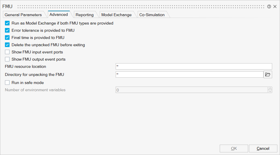

run_as_me | Run as Model Exchange if both FMU types are provided | If the FMU provides both the Model Exchange and Co-Simulation API's, you can select the check box to apply the Model Exchange API, otherwise the Co-Simulation API is applied. | Scalar | 0 |
tolerancecontrolled | Provide error tolerance to FMU | Select this check-box to activate tolerance-control of the FMU. If the checkbox is checked, the FMU model is called with a numerical integration scheme where the step size is controlled by using the relative error tolerance for error estimation. In such a case, all numerical algorithms used inside the model operate with an error estimation of an appropriate smaller relative tolerance. If the fixed-step solver is used, this checkbox may be off. | Scalar | 0 |
stoptimedefined | Provide final time to FMU | Final time of the model defined in simulaton setup is provided to the FMU. | Scalar | 0 |
deleteafteruse | Delete the unpacked FMU before exiting | The import block unzips the FMU on each run. Select the check box to delete the unzipped folder after the simulation runs. | Scalar | 0 |
inevent | Show FMU input event ports | Select the check box to enable the input event ports of the FMU import block. The FMU import block has two input event ports: External and End. The External event can be activated by any event and puts the FMU (of type ME) into the event iteration mode. The End event puts the block into terminate mode. | Scalar | 0 |
outevent | Show FMU output event ports | Select the check box to enable the output event ports of the FMU import block. The FMU import block has two output event ports: Discrete and End. The Discrete event is triggered when a time event is programmed inside the FMU block. The End event is triggered when the FMU requests a termination. | Scalar | 0 |
resources | FMU resource location | Location of the resource folder for the FMU. If a location is not specified, the default location is fmu://resources. | String | |
tempdir | Directory for unpacking the FMU | Specify a folder to unzip the FMU. If a folder is not specified, the FMU is unzipped into a temporary folder. | String | |
ipc | Run in safe mode | If enabled, the FMU is loaded inside another process. This protects Twin Activate from crashes in the FMU. Simulations run slower in this mode. | Number | 0 |
nEnvVar | Number of environment variables | Number of environment variables to pass to FMU. | Number | |
EnvVars | Environment Variables | If safe-mode is activated, the user can define environement variables to be visible only in the new process by the FMU. | Structure | |
EnvVars/varname | Name | Name of the environment variable to pass to FMU. | Cell of strings | |
EnvVars/varvalue | Value | Value of the environment variable to pass to FMU. | Cell of strings |

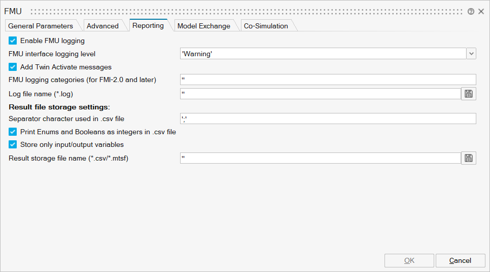

enable_fmulogging | Enable FMU logging | Select the check box to enable the logger. | Number | 0 |
simloglevel | FMU interface logging level | Select a logging level for the interface to the FMU block. The levels Info, Warning, and Error are registered. | String | 'Nothing' |
add_Activate_messages | Add Twin Activate messages | Select the check box to include messages from Twin Activate in the log file. | Scalar | 0 |
fmulogging_cats | FMU logging categories (for FMI-2.0 and later) | The FMU can filter log messages. You can enter the required log categories. Log categories should be protected by double quotes and separated by a comma. | String | |
log_file_name | Log file name (*.log) | The log file name to be created. If this field is left empty, the logger is disabled. | String | |
csv | Separator character used in .csv file | The separator character in the output .csv file. | String | |
out_enum_as_int_flag | Print Enums and Booleans as integers in .csv file | Select the check box to activate the Enum values as integers, otherwise the text values are stored. | Scalar | 0 |
log_only_outputs | Store only input/output variables | Select the check box to store only input and output variables in the .csv and HDF files to reduce output file volume. | Scalar | 0 |
result_file | Result storage file name (*.csv/*.mtsf) | The full path of the output result file. The output file can be either a .csv or HDF file (with extension *.mtsf). | String |

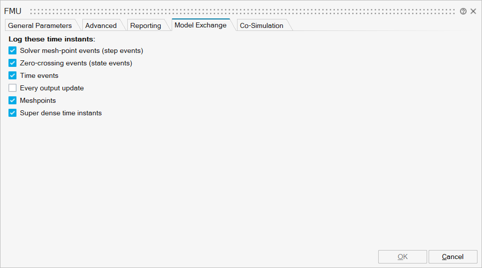

stepevent | Solver mesh-point events (step events) | If activated, the value of each variable is stored at the time instant when a step event occurs. | Scalar | 0 |
stateevent | Zero-crossing events (state events) | If activated, the value of each variable is stored at the time instant when a state event (zero-crossing event) occurs. | Scalar | 0 |
timeevent | Time events | If activated, the value of each variable is stored at the time instant when a time event occurs. | Scalar | 0 |
OutputOn | Every output update | If activated, the value of each variable is stored at the time instant when the block outputs are updated. | Scalar | 0 |
meshpoints | Meshpoints | If activated, the value of each variable is stored at the solver mesh points. | Scalar | 0 |
superdensetimes | Super dense time instants | If activated, the value of each variable is stored at the super dense time instants of the discrete events. | Scalar | 0 |

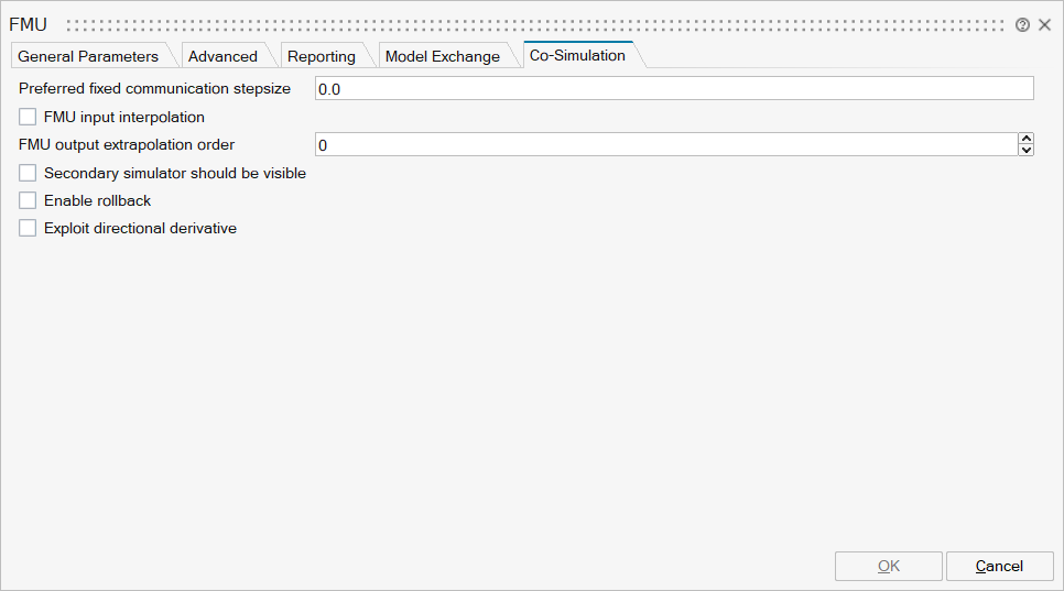

fixedComStepsize | Preferred fixed communication step size | FMUs of type Co-Simulation are simulated by performing input and output updating at intervals called communication points. The communication points can be defined by the Twin Activate solvers or constant time. In the latter case, the constant communication interval size is provided here. This option is valid for FMI 2.0 and later. | Scalar | |
provideDerivative | FMU input interpolation | If activated, the first derivative of inputs is computed using the numerical differentiation method and is given to the FMU/CS. | Scalar | 0 |
exploitOutDerivative | FMU output extrapolation order | Defines the order of extrapolation of outputs. A higher order could help to get smoother signals. | Number | |
visible | Secondary simulator should be visible | If activated, the FMU/CS is co-simulated interactively. | Scalar | 0 |
EnableRollback | Enable rollback | Apply GetFmuState and SetFmuState APIs to solve algebraic loops if the FMU supports these APIs. | Scalar | 0 |
EnableDirectDer | Exploit directional derivative | If activated and the FMU provides directional derivative for Cosimulation, directional derivative will be used to compute the Jacobian of the model. | Scalar | 0 |
