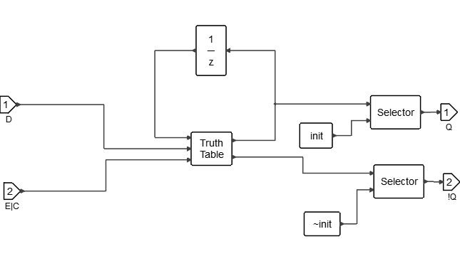

When the E/C port of the block is 0, the D input has no effect on the outputs. When The E/C is high, the Q output is equal to D.
Activate/FlipFlops
When the E/C port is true, the block is enabled the truth table of inputs and outputs can be found as following:
D Q !Q
0 0 1
1 1 0
When the E/C port is false, the output ports keep the value of previous step. Non-zero is considered true and zero is considered false.

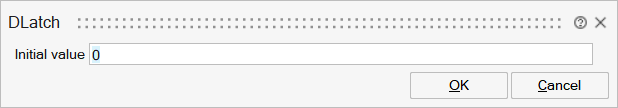

init | Initial value | Initial Value: Output at port Q at initial time. |
