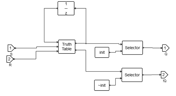

This block sets its output when the S port is high and R is low, resets its output when the R port is high and S port is low, !Q is the complement of Q. While both S and R are low, the SR Flip Flop maintains the Q and the !Q outputs in a constant state. If both S and R are high, Q and !Q are both low.
Activate/FlipFlops
The SR flip flop block sets its output when the S port is high and R is low, resets its output when the R port is high and S port is low, !Q is the complement of Q.
Truth table for the inputs and outputs are listed as following:
S R Q !Q
0 0 Qn-1 !Qn-1
0 1 0 1
1 0 1 0
1 1 0 0

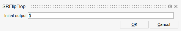

init | Initial output |
