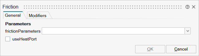

Name | Label | Description | Data Type | Valid Values |
mo_frictionParameters | frictionParameters | Friction loss parameters | FromModelica('Modelica.Electrical.Machines.Losses.FrictionParameters') | |

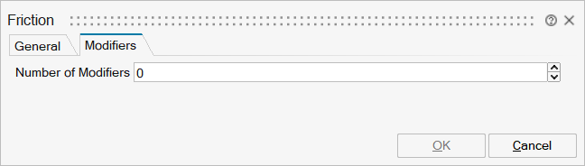

mo__modifiers/varname | Variable name | Cell of strings | 'phi' | |
mo__modifiers/value | Value |
