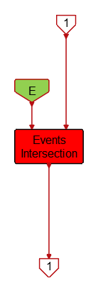

GetEvent
Get Event (Activation signal) when activated
StateMachine
GetEvent and SetEvent blocks are based on Base library blocks GetActivationSignal and SetActivationSignal blocks, and are used to communicate activation signals (events). The GetActivationSignal provides an event only if the named event occurs and the block is activated, synchronously. The IsEventActive block is a slight variation on this block, presenting the result as a regular signal: when activated, it outputs 1 if the named event is activated, 0 if not.
